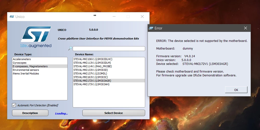

MKI172V1 not supported by motherboard
Posted on March 16, 2017 at 17:50
I have a MKI72V1 adapter board. On Unico with V5 it does show up on the devices list however when I select the device I get an error message saying the device is not supported by the motherboard. Please advise.

Miroslav BATEKBest answer
Mar 17, 2017 10:07 AM UTC
Posted on March 17, 2017 at 11:07
Can you please update the firmware in your board. You need the firmware which is distributed in the STSW-MKI109W together with the Unico v5.0.0.
Please check the directory DFU and the UM0412 - DFU User Guide.pdf for instruction how to update the FW.

Soumya Subramanya
Mar 17, 2017 2:50 PM UTC
Posted on March 17, 2017 at 14:50
Hello and thanks for your response. I checked the DFU folder and it contained the eMotionV5.0.0.dfu file. However After updating FW using this file it still results in the same error.

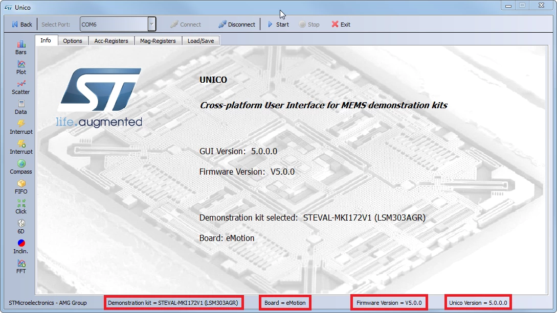

Mar 17, 2017 3:10 PM UTC
Posted on March 17, 2017 at 15:10
Yes, the eMotionV5.0.0.dfu is the correct file. Are you sure that the FW upgrade was done correctly. Do you see that the firmware version is now 5.0.0 in Unico?
