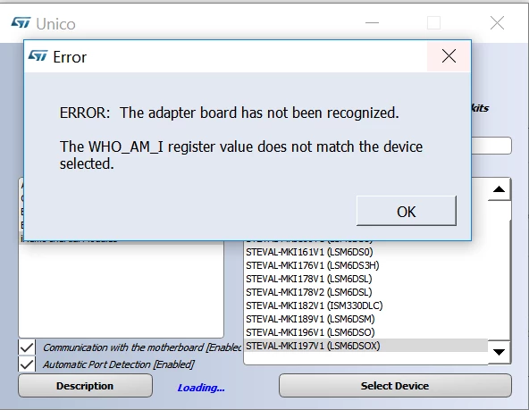

MKI109V3 with MKI197V1 problem
I have asked this question in community also but no answer till now.
I have got below devices as one of your colleague offered me via email.
I have a MKI109V3 and one MKI197V1.
I have downloaded the related tools&software of MKI109V3 then I opened the DfuSe Demo from en.stsw-mki109w / MEMS_Demonstration_Kit_SW_package_v8_0_WINDOWS and upgraded ProfiMEMSToolV2.40.1.dfu from ProfiMEMSTool board in DFU folder.
the last step was using UNICO 8.0.1.0 to choose MKI197V1(LSM6DSOX).
But I have below error!!
I will appreciate if let me me know what the problem is.

    hi, it's very strange indeed. Did you check if it's really an LSM6DSOX? Is it possible for you to share the oscilloscope SPI pattern? You should read 6Ch during initial WHO_AM_I (reg 0Fh) check. Regards

    hi, thank you for answering. unfortunately I dont have access to oscilloscope. maybe takes time to reach one.
