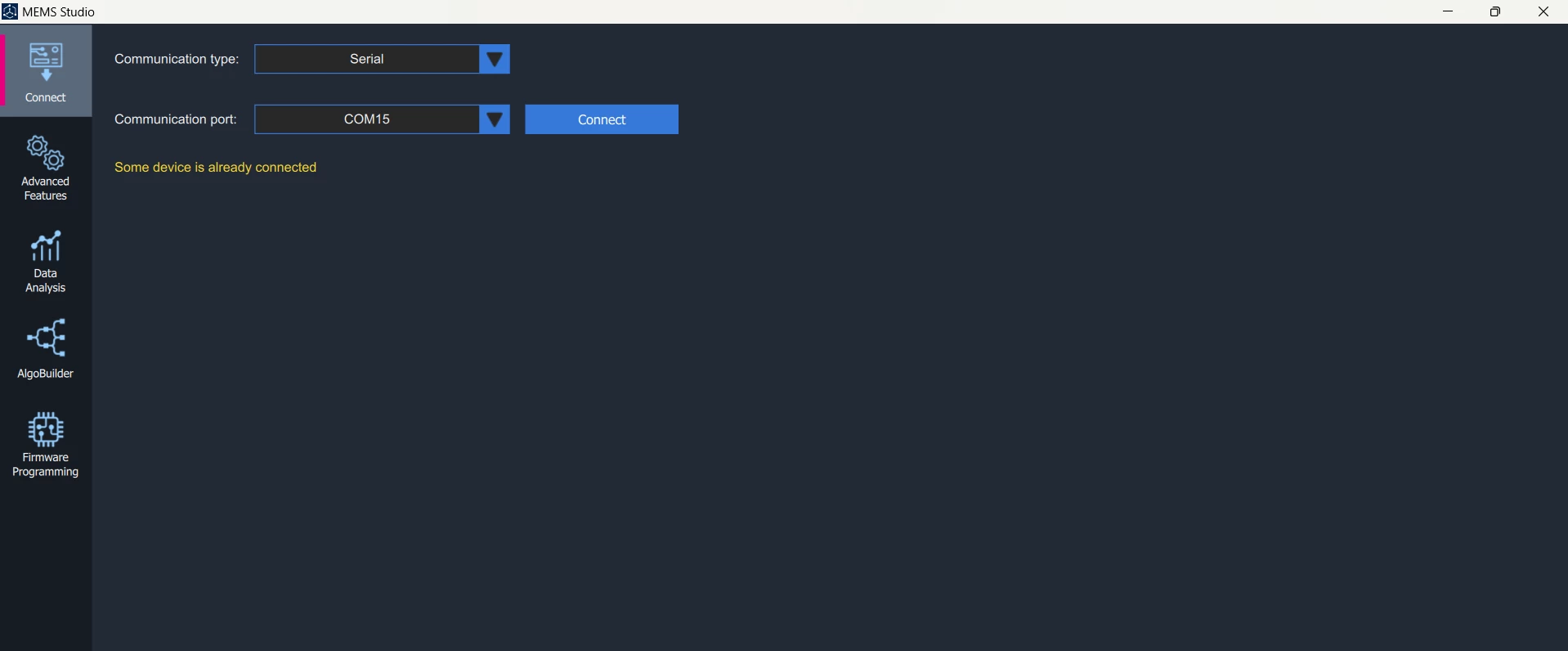

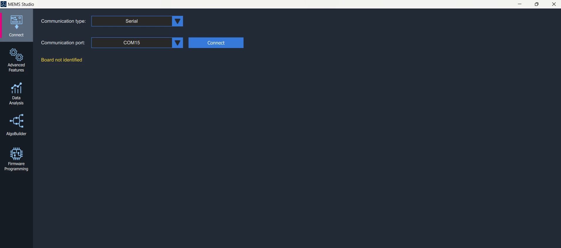

I have an X-NUCLEO-IKS4A1 mounted on top of a NUCLEO-L476RG and I am trying to connect that to Mems Studio. I get one of the two errors in the attached screenshots. Either "Board not identified" or "Some device is already connected".

Hello @tarunprasadoff
The NUCLEO (STM32) must be programmed with compatible firmware with MEMS Studio.
You can check chapter 2.6 Hardware and firmware compatibility in UM3233.
NUCLEO-L476RG + X-NUCLEO-IKS4A1 can be used in AlgoBuilder in MEMS Studio.
Sensor evaluation firmware (DatalogExtended) is unfortunately not available for NUCLEO-L476RG, please check X-CUBE-MEMS1 package.

I do not have any project file. I have only connected the NUCLEO-L476RG to my windows device. I have the X-NUCLEO-IKS4A1 mounted on top of the NUCLEO-L476RG at the same time. I opened MEMS Studio and tried clicking on the Connect button in the Connect Tab after selecting the correct port number. This is the error that is being thrown. How do I successfully connect now?
July 15, 2024
Hello @Apollo1
the MEMS Studio opens the serial port and send "CMD_Read_PresString" command to read presentation string. This string describes the firmware and MEMS Studio can adjust the GUI according to the connected firmware.
The firmware from X-CUBE-MEMS1 will not work properly without appropriate X-NUCLEO board connected so it will not able able to respond to the "CMD_Read_PresString" command and the connection will not be establisted.

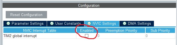

I don’t have the NUCLEO-G491RE available at the moment, but I did a quick check of your STM32CubeMX project. I noticed one issue - the interrupt from TIM2 is not enabled.
Please enable this interrupt and try again with MEMS Studio. I believe you should see the sensor data coming from the firmware. If not, please let me know, and I will try to get the NUCLEO board to debug the issue.

My colleague analyzed the project and here are his recommendations:
  • No need to select MotionMC&EC libraries if you want to generate IKS4A1_DataLogFusion application, just MotionFX is needed but of course you can keep it there.
  • Circular Mode in DMA settings has to be disabled.
  • I've changed TIM1 to TIM3.
  • I've changed USART2 to USART3.
  • I've increased Minimum Stack Size to 0x4000.
  • Now the project generates correctly and works with MEMS Studio, you can try the attached ioc.
  • You can find settings description for devices supporting Linked-List in chapter 4.3.2 of User Manual for X-CUBE-MEMS1 v12.0.0. We do not set LINKEDLIST section in CubeMX for our projects, you can compare your project to "X-CUBE-MEMS1_v12.0.0"\Firmware\Projects\NUCLEO-U575ZI-Q\Applications\IKS4A1\DataLogFusion\ for details.

I was able to generate the code, build and program the board using the H503RB_MEMS_App_ST.ioc file you provided. MEMS-Studio was able to connect to the board successfully.
I have tried updating my version of the ioc file in Cube-MX and I wanted to add some comments based on your feedback and point to some issues I experienced in the process.
TIM1 does work, however, I think TIM1 should be allocated for more complex setup such as Half-H bridge implementation (BLDC or Digital Power Supply).
TIM3 is a basic general purpose timer.
On MB1814 project schematic for NUCLEO-503RB, UART over USB (Virtual Com Port) signals VCP_RX and VCP_TX are mapped to pin PA3 and PA4 which belong to USART3.
Within Cube-MX, pin assignment for signals VCP_RX and VCP_TX can be found under "Bsp" section when "Human Machine Interface" with VCOM is checked. Though VCOM has to remain "Unchecked" as it can't be used in the X-CUBE-MEMS1 USART "Found Solutions".
Using default "Minimum Stack Size" of 0x400 will cause a HardFault.
The HardFault condition can only be seen when running STM32Cube_IDE in debug mode.
So best to avoid using MEMS-Studio "Firmware Programming" to flash the board until it has been shown that MEMS-Studio has been able to connect.
I did follow up on the documentation but I may have overlooked or misinterpreted the "Circular Mode" setting.
Having "Circular Mode" set to "Enable" will cause the following error during the build:
error: 'NodeConfig' undeclared (first use in this function)
666 | NodeConfig.NodeType = DMA_GPDMA_LINEAR_NODE;
On a side note, if "Visibility (Static)" for the Timer is "checked" (under "Project Manager" => "Advanced Settings"), the following error will be reported:
undefined reference to `MX_TIM3_Init'
Once all the above steps have been taken care of, then I can successfully build the code and connect with MEMS_Studio.
