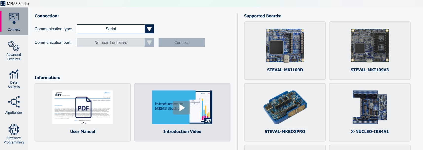

MEMS Studio Not Detecting STEVAL-MKI109D
I followed 'STEVAL-MKI109D Professional MEMS Tool motherboard for MEMS adapter boards' and installed MEMS Studio.
I then placed STEVAL-MKI250KA on STEVAL-MKI109D by following UM3420 and AN6173.  When I boot MEMS Studio, it just does not recognise the board either via bluetooth or serial.
I also installed https://www.st.com/en/development-tools/stsw-stm32102.html
Any ideas what I am doing wrong?

Hi @seanjm ,
STEVAL-MKI109D does not have bluetooth this is why it does not work.
As for the serial, have you installed cube programmer?
