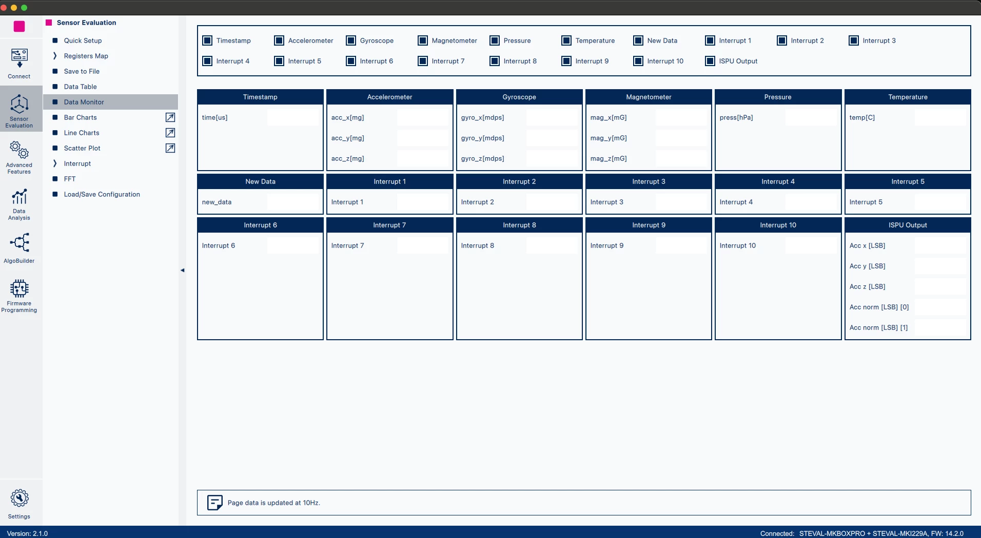

I'm struggling to monitor the debugging values on the MEMS studio.
setup
1. MEMS studio 2.1.1 (latest version)
2. Sensor PRO Tile Box + STEVAL-MKI229A(LSM6DSO16IS)
3. ST Official ispu-example GitHub, norm
https://github.com/STMicroelectronics/ispu-examples/blob/master/ism330is_lsm6dso16is/norm/output/norm.json
4. ispu-examples/ism330is_lsm6dso16is/norm/output/norm.json
    loading this json to the board through MEMS studio
5. I can see the entire blank on the "Data Monitor" Page with checked "ISPU Output".

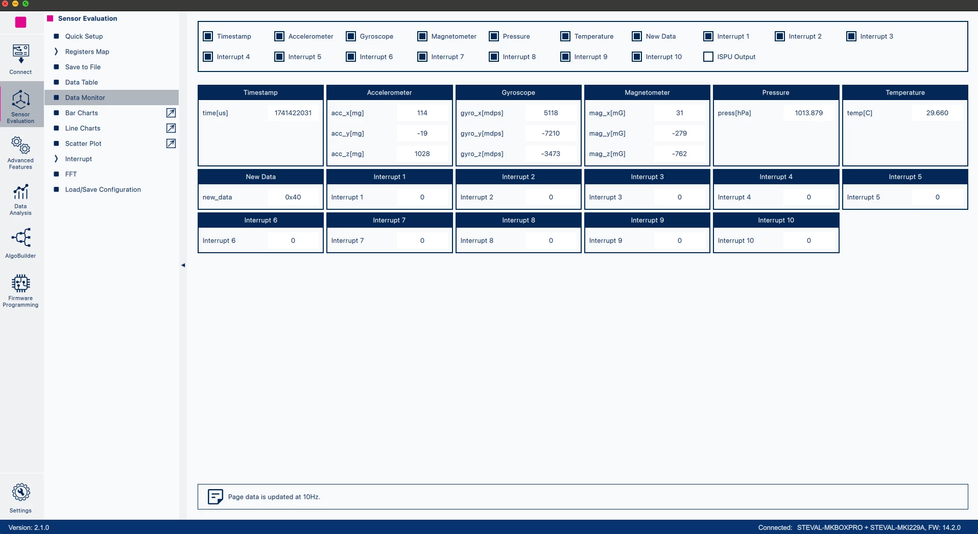

6. Toggle the "ISPU Output" to the un-checked state, everything can back to the normal.

Hello Moonseop,
Thanks for notification.
Streaming ISPU data is not supported in this firmware; however, we are considering adding support in the next version.
