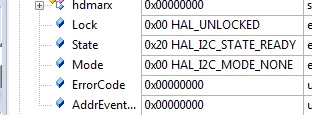

 HAL_I2C_IsDeviceReady return HAL_OK. HAL_I2C_mem_read also returns HAL_OK of 0x00.

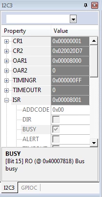

But I still have Who_Am_I problem which didnt return 0x68. In ISR Register of I2C_3, the BUSY FLAG is HIGH.
Do you have Idea? Thank you.0693W00000DmU8DQAV.png0693W00000DmU88QAF.png0693W00000DmU8IQAV.png
