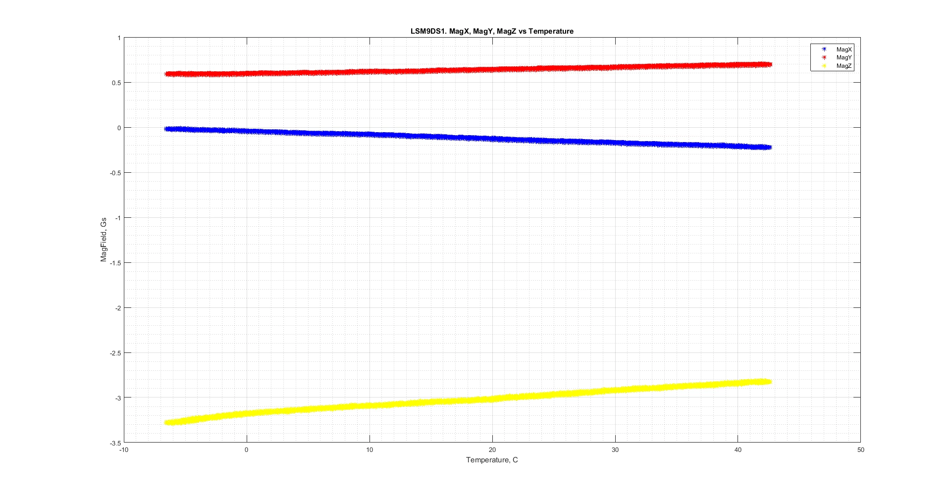

sergeyvslnko
Jul 7, 2018 8:35 AM UTC
Posted on July 07, 2018 at 10:35
Yes, magnetometer offset depends over temparature and have to be compensated.
PS My evaluation board was fixed to metall surface  by
magnetic fasteners, that is why absolute value of measured magnetic field more than Earth magnetic field value.
Temperature compensation bit was set.
