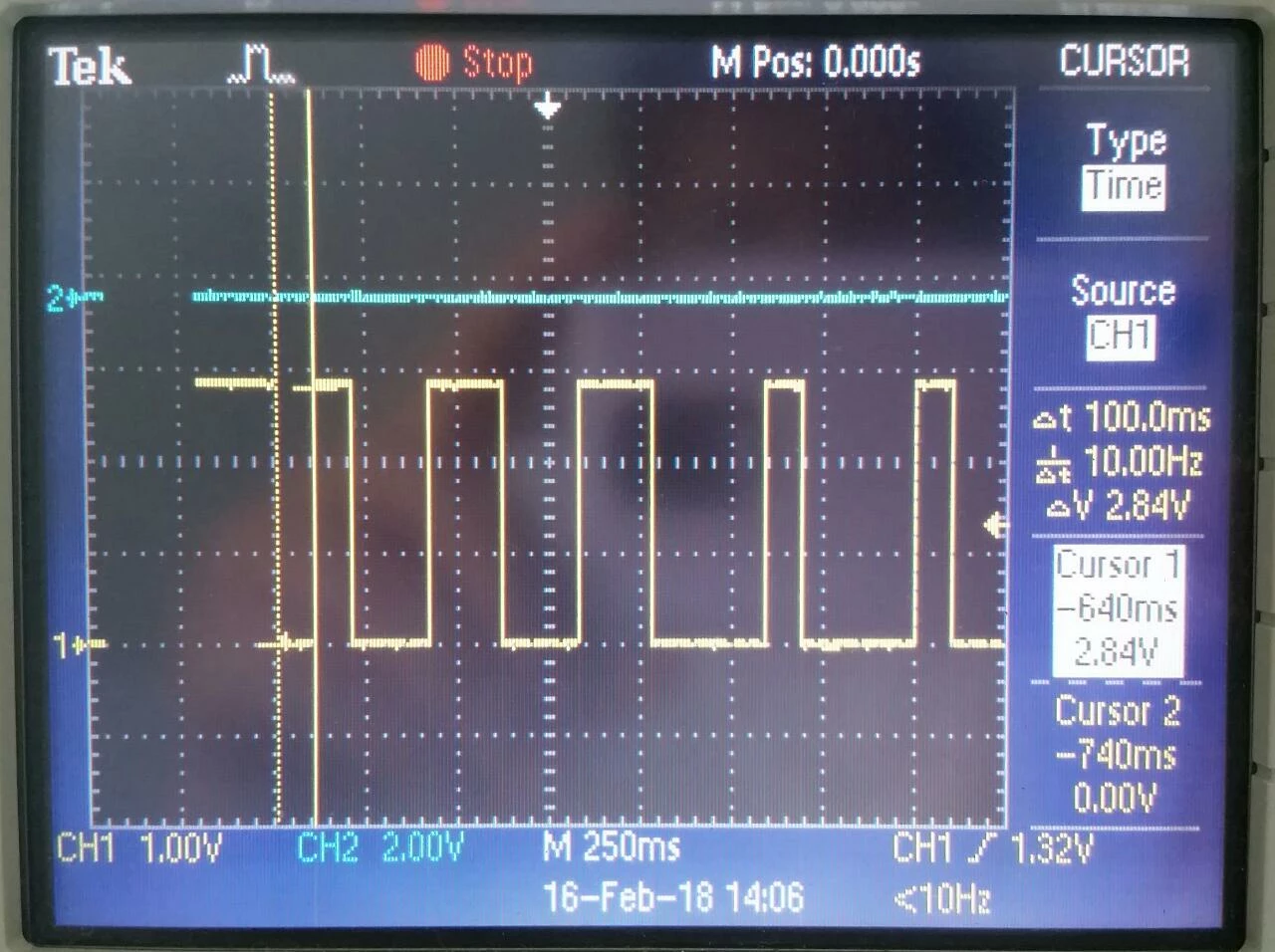

hi everyone!
i did this configure LSM9DS1:
//Magnetometer
    Write1AddressMag(CTRL_REG1_M,0x70);
    Write1AddressMag(CTRL_REG2_M,0x00);
    Write1AddressMag(CTRL_REG3_M,0x00);
    Write1AddressMag(CTRL_REG4_M,0x0c);
    Write1AddressMag(CTRL_REG5_M,0x00);
    Write1AddressMag(INT_CFG_M,0x00);//no interrupt
the frequency should be 10Hz to Z axis magnetic
this is not occur.
my code:
while(1){
      if(STATUS_REG_M & 0x04){
         PIN_OUT ^= 1;//Toggle pin
         read3axisMagnetic();
Does anyone have any ideas?
Thanks
