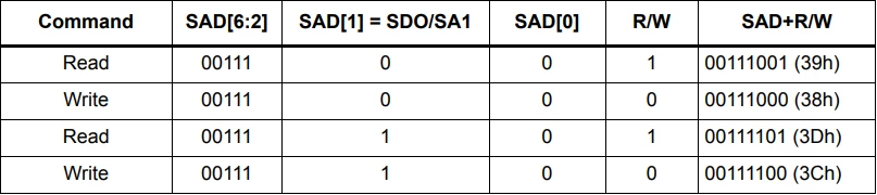

I have confusion about I2C address for magnetometer.
As in the datasheet at page 11:
  • SDO_M: I2C least significant bit of the device address (SA0) for the magnetometer
But in the table 20 page 30:
  • See picture enclosed
It looks like the SDO_M pin is used for SAD[1] since the SAD[0] is not change.
Please help me in this case, is it correct?

    that data sheet looks crazy...
    pins CS_A/G and CS_M How are they set ?

    your using SCL/SPC as the clk and SDA
    read = 00111
    pin SDO its a typo..
    5 SDO_A/G
    SPI serial data output (SDO) for the accelerometer and gyroscope
    I2C least significant bit of the device address (SA0) for the accelerometer
    and gyroscope
    6 SDO_M
    SPI serial data output (SDO) for the magnetometer
    one will be SA0 and the other will be SA1,
    are SD)_A/G and SDO_M both Low ?
    your address is :
    read = 00111 0 0 1
    Write = 00111 0 0 0
