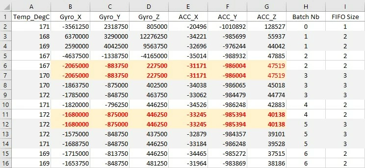

LSM9DS1, FIFO, Duplicated data
I'm acquiring gyros and accelerometers data through i2C bus, pulling the data from the FIFO asynchronously from the component acquisition frequency, but at a frequency close by (to avoid overfilling the FIFO).
Without metrological tools, I can still confirm readings are OK ( "g" on the axe pointing downward, sign of rotation etc ...).
However, when looking closer to the data, some are duplicated from one FIFO emptying to the next:0690X00000AsaAtQAJ.jpg
LSM is acquiring at 59.5Hz. I've tried to collect at several frequencies: 60Hz, 50Hz, 40Hz or 200Hz. Behavior occurrence vary, but is always present. Also, as visible on the table, it is not systematic, but when happening it is always first sample compare to last sample of previous batch.
Before reading the FIFO, I'm checking STATUS_REG for new data, and FIFO_SRC for FIFO size. Which, btw, highlights the Temp, Acc and gyro data are not writing in a single shoot into the FIFO.
I'm struggling on this topic for several days now. I'm about to write a turn around to compare last recorded sample to the first one of a new batch: but it is ugly.
Anyone encounter such behavior, or could provide any tips about what I'm doing wrong?

    wpaul
    wpaulBest answer
    Jan 10, 2020 2:48 PM UTC
    Issue is fixed :)
    It cames from the use of the "ioctl(iHandeler, I2C_RDWR, &sI2cDataSet);" methode. When returning to a regular posix read() methode, all worked well (obviously it take more time).
    At last to answer to @Eleon BORLINI​ question: LSM9DS1 datasheet mention "Temperature sensor output = 0 (typ.) at 25 °C, temperature sensitivity: 16 LSB/°C". So my sensor temperature was some 35°C, which is reasonable, the component being close to my µP.
    Cheers

    Eleon BORLINI
    Nov 28, 2019 3:46 PM UTC
    Hi @wpaul​ , one question before going deep in the request... are you really working at about 170 degrees Celsius? Regards
    wpaul
    wpaulAuthor
    Dec 2, 2019 8:58 AM UTC
    Hi @Eleon BORLINI​
    Sorry I was away for a while.
    No, temperature is room temperature, some 22°C. The 170 came straight from the LSM9DS1. I believe it is shown in some tens of degree, but there must be some scale factor. I have some records made in a temperature chamber, so it will give me more insight about.
    Regards
    wpaul
    wpaulAuthorBest answer
    Issue is fixed :)
    Cheers
    Eleon BORLINI
    Jan 13, 2020 10:21 AM UTC
    Hi @wpaul​ , maybe the use of "ioctl(iHandeler, I2C_RDWR, &sI2cDataSet);" method for FIFO asynchronous mode missed a few samples during the reading, or you were too fast in reading the FIFO and the data was not yet updated... did you try to set the BDU bit in CTRL_REG8 (22h) before switching method? Regards
