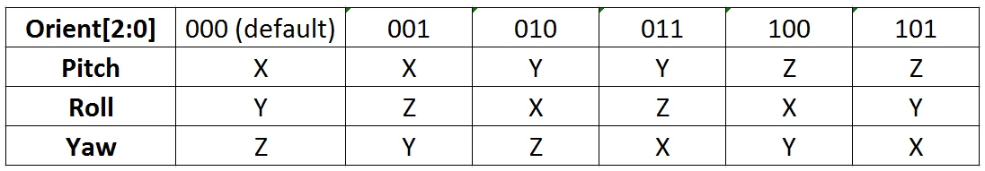

LSM9DS1 has the register ORIENT_CFG_G(13H).
What mean its bits     Orient[2:0]    Directional user orientation selection ?

    The bits Orient [2:0] in register ORIENT_CFG_G (0x13) can be used to change the axis orientation, as reported in following table.

    Thank you,
    this table I've found in the datasheet for LSM6DS3US (September 2017  DocID028476 Rev 5).
    As I use datasheet for LSM9DS1 (March 2015  DocID025715 Rev 3) the table is absent here.
    There are some other reasons as well to ask: which release of datasheet for LSM9DS1 is the latest one?
    Which others documents can be used for LSM9DS1 may be with some notes (e.g. I’ve seen an explanation of self-test for LSM9DS1 on base of a document for another chip).
    March 15, 2018
    Posted on March 15, 2018 at 16:56
    The datasheet DocID025715 Rev 3 from March 2015 is the latest one.
    Yes, the table is missing there, it should be fixed soon.
    There is no other document for LSM9DS1.
