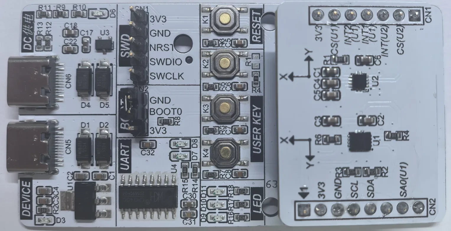

First, prepare a development board. In this example, I use a development board designed by myself. Those who need the board may apply for one.
The main controller is the STM32H503CB, the IMU is the LSM6DSV80X, and the magnetometer is the LIS2MDL.

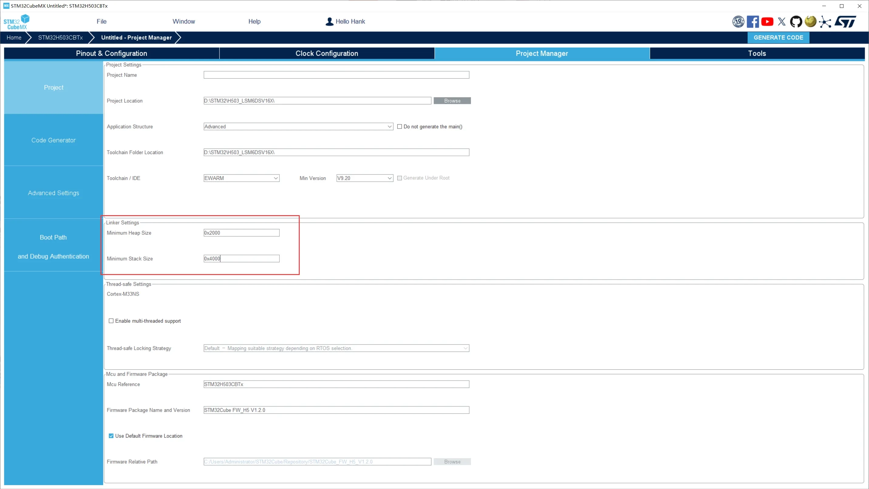

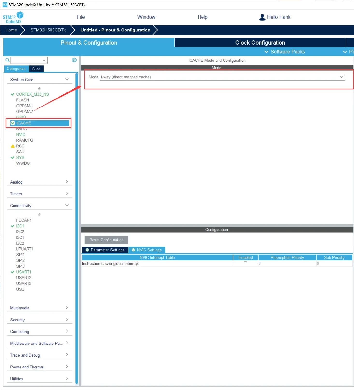

Generating the Project with STM32CubeMX

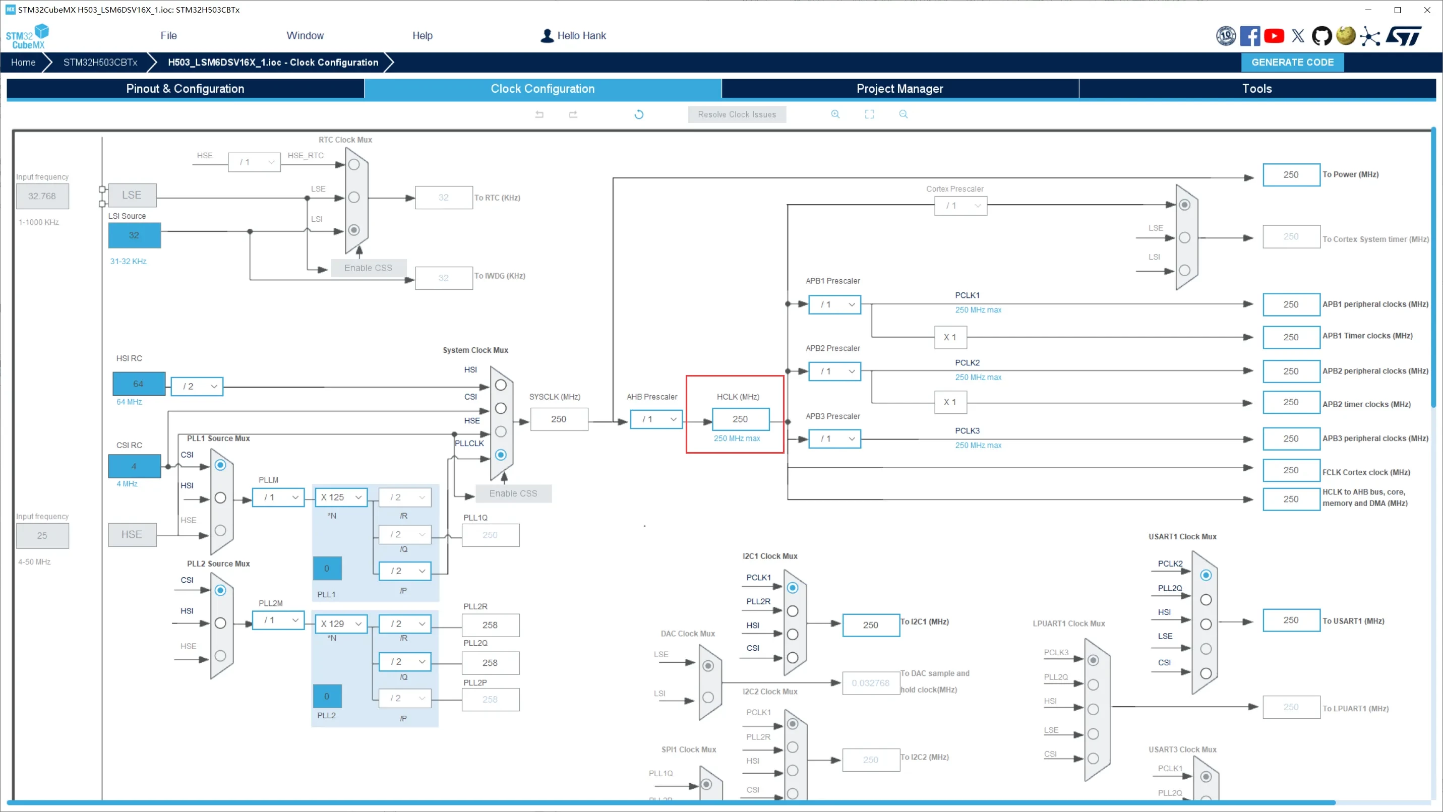

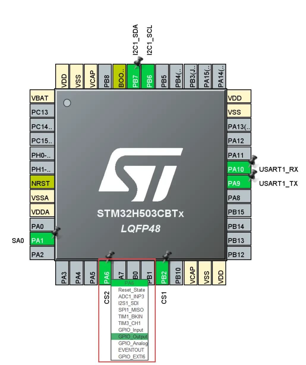

Use STM32CubeMX to generate the example project. The MCU used in this project is the STM32H503CB.

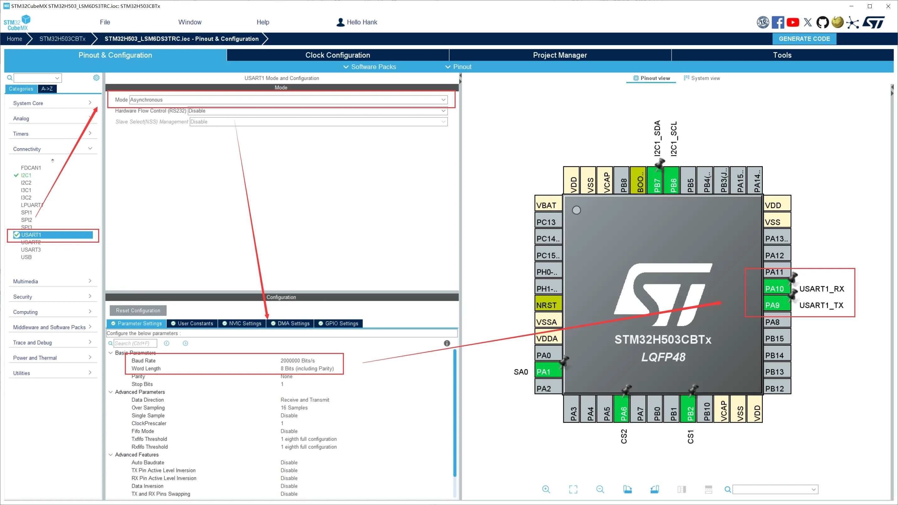

Configure the clock tree and set the system clock frequency to 250 MHz.

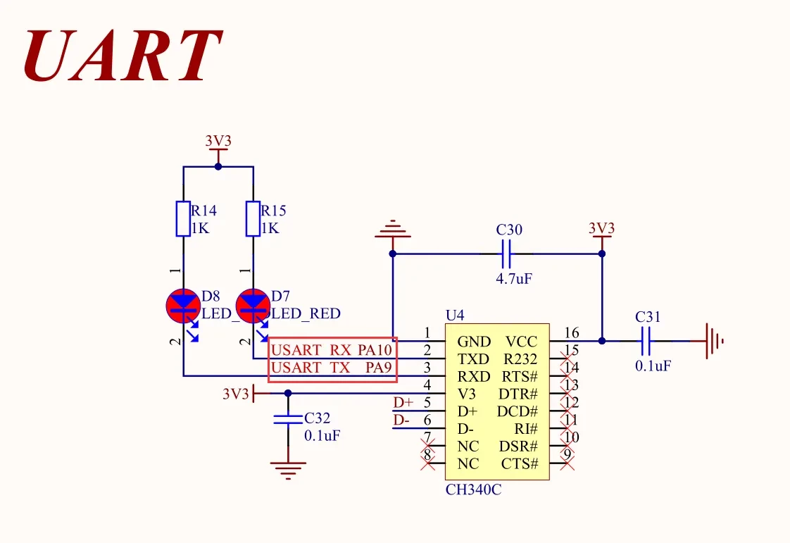

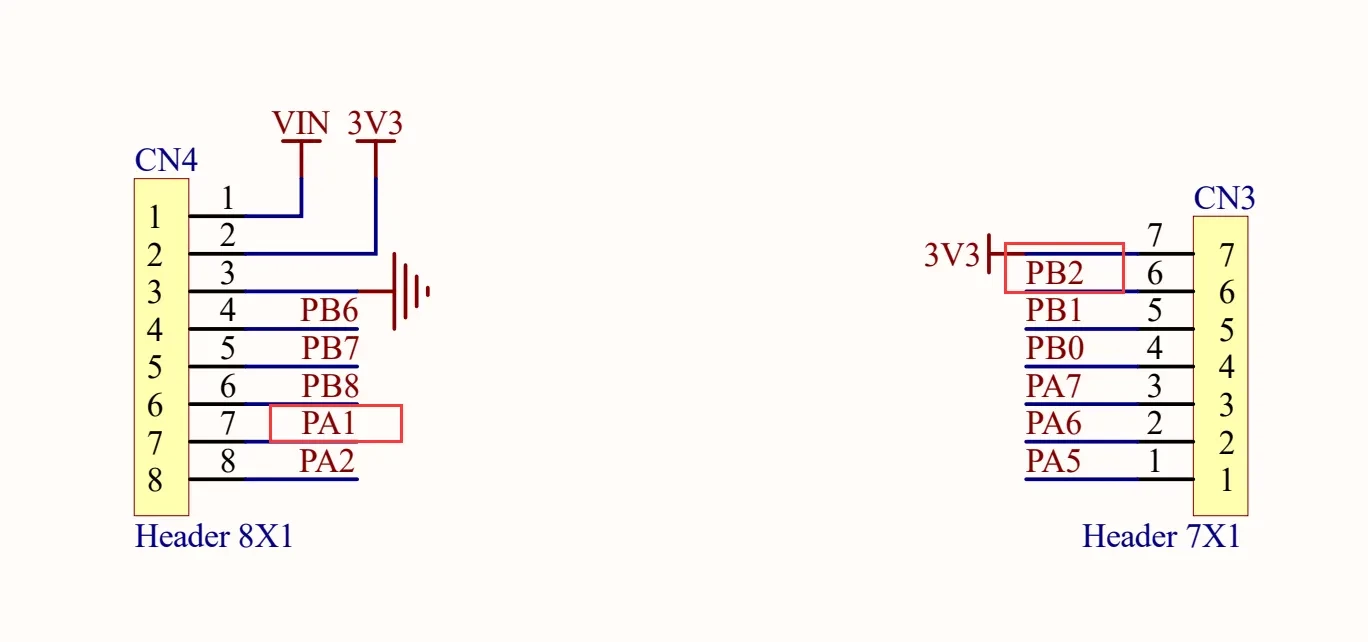

UART Configuration
According to the schematic, PA9 and PA10 are connected to the development board’s UART interface.
Configure the UART baud rate to 2,000,000 bps.

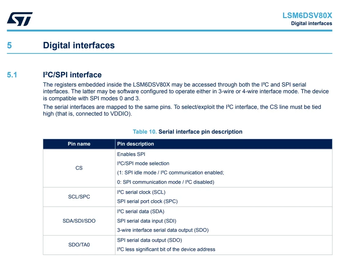

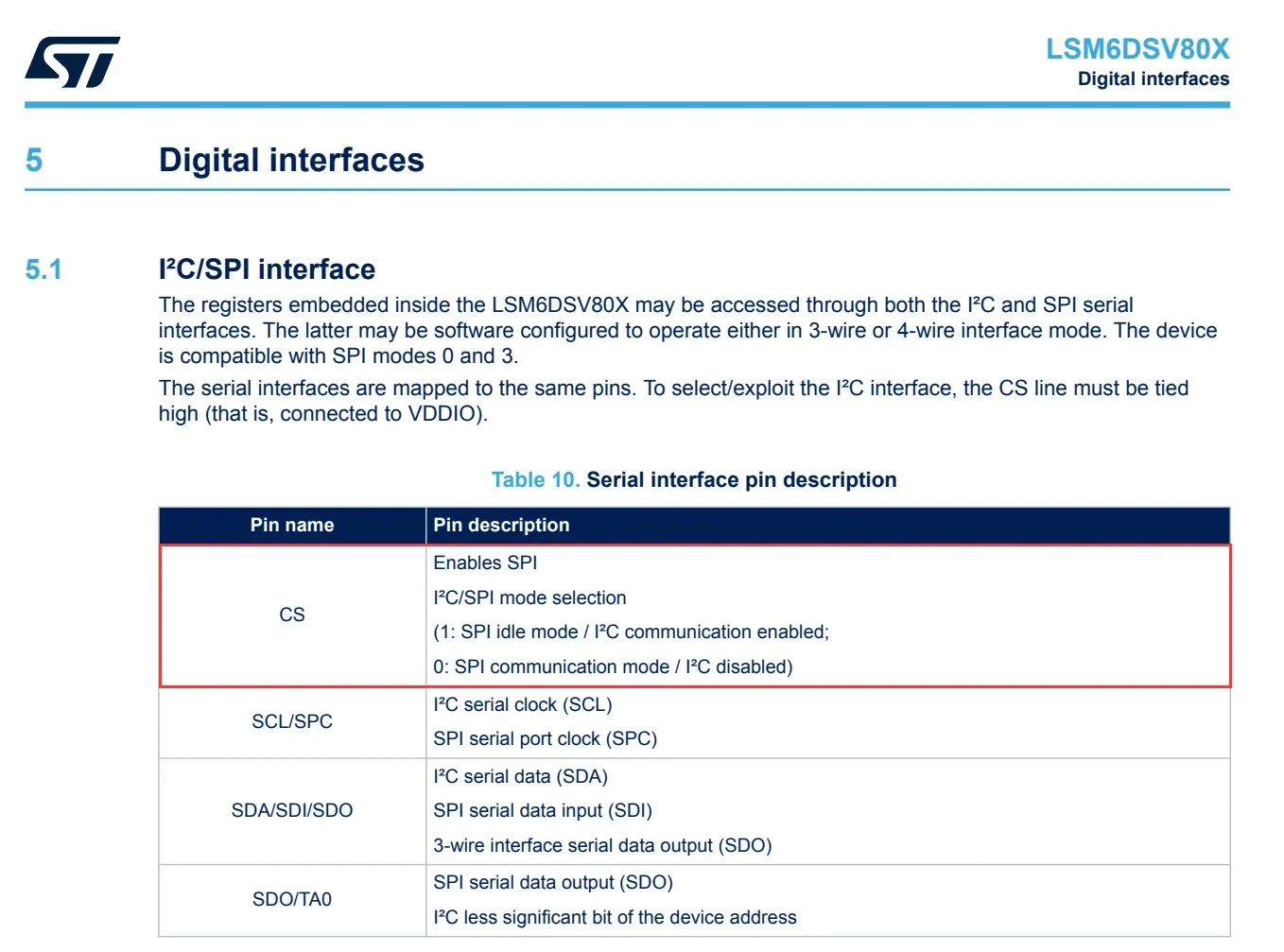

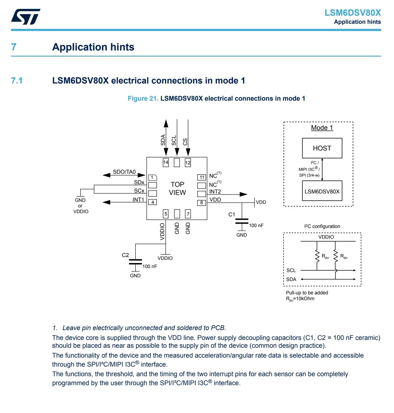

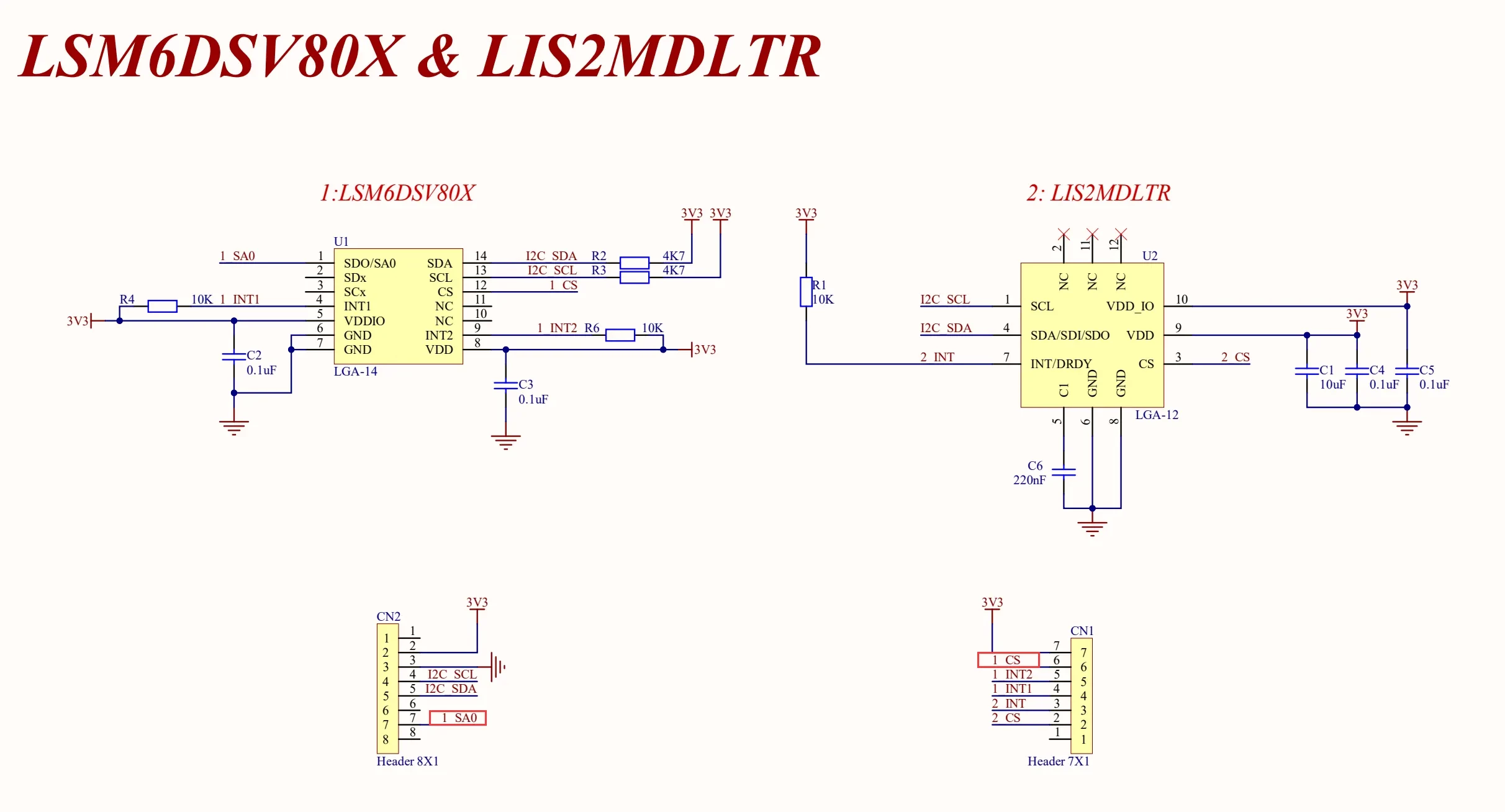

The LSM6DSV80X supports both SPI and I²C communication interfaces.

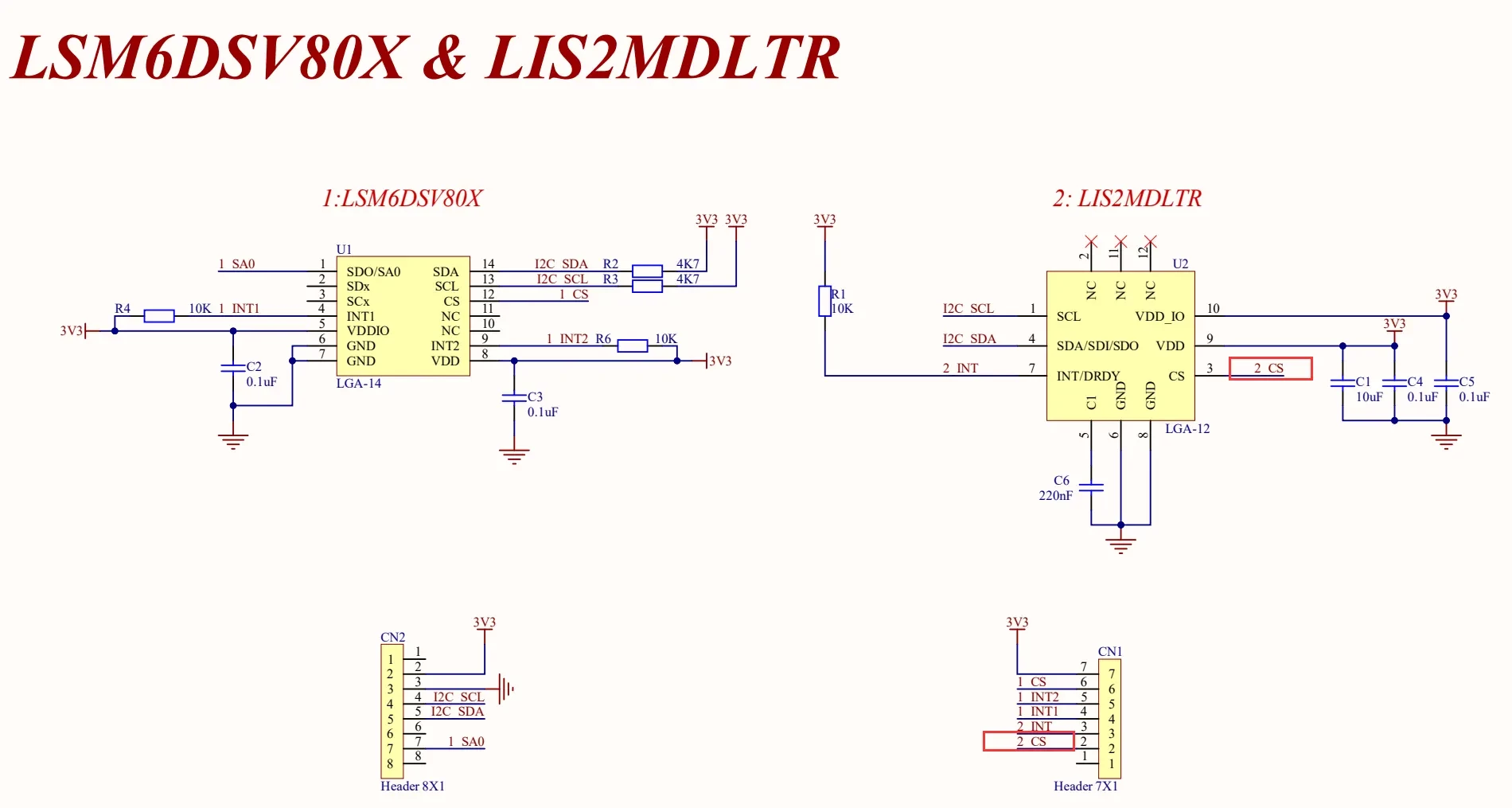

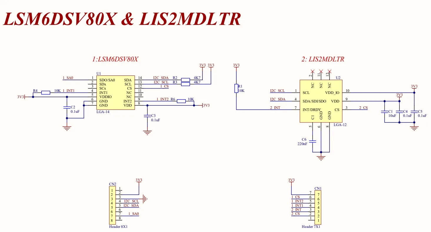

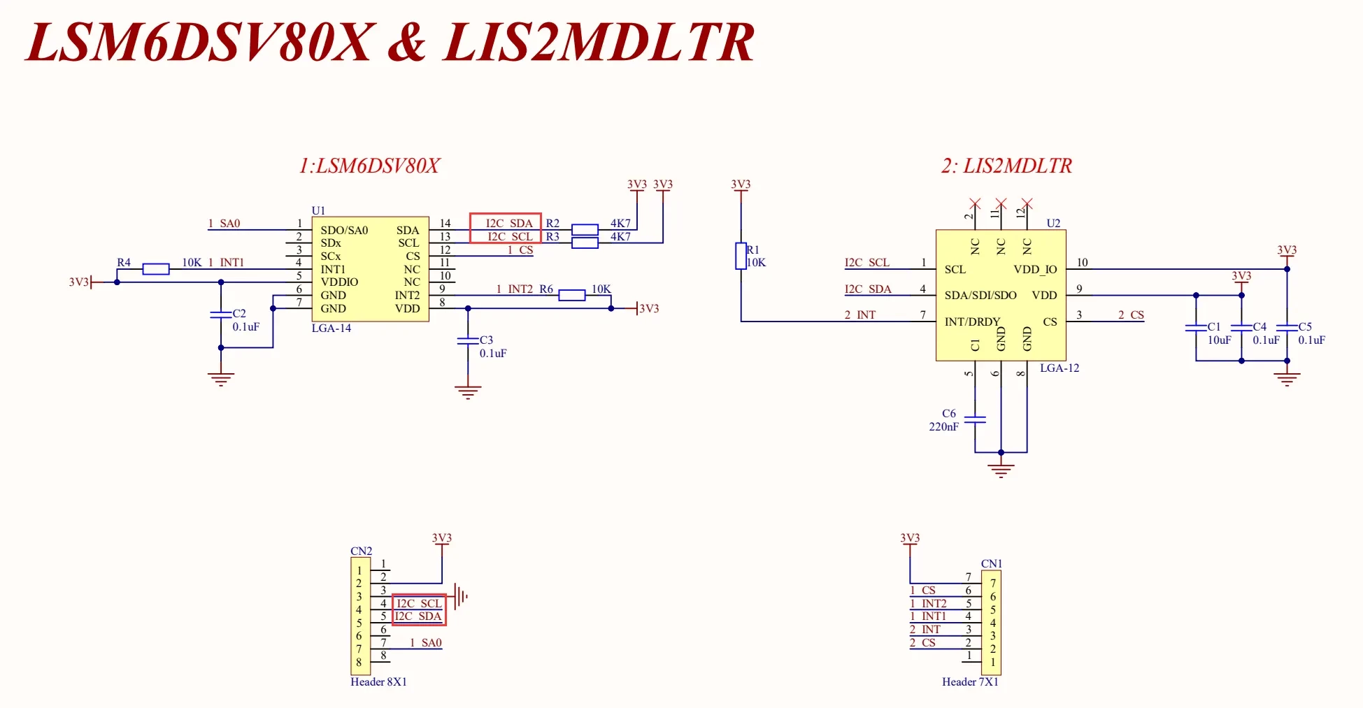

The minimum system circuit is shown below.
When the CS pin is pulled high, the device operates in I²C mode.

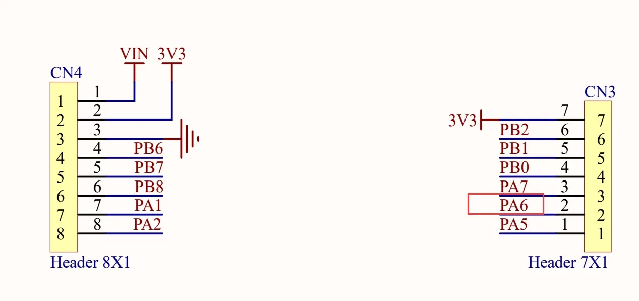

The schematic of the development board used in this article is shown below.

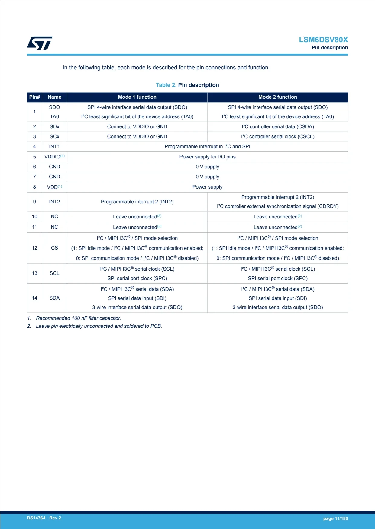

Pin Definition

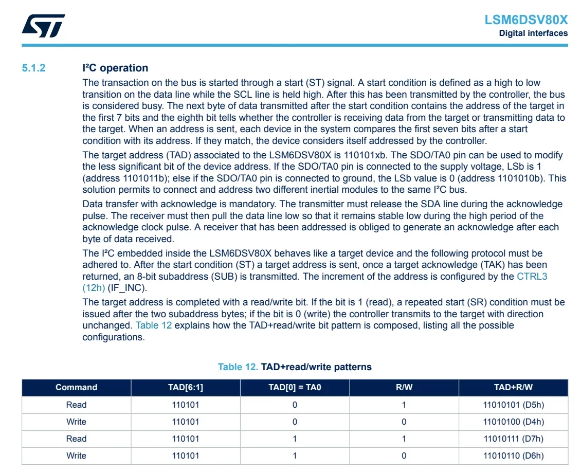

I²C Communication Mode
When the I²C communication interface is used, the SA0 pin determines the least significant bit of the device’s I²C address.
The device address can be configured through the SA0 pin:
  • When SA0 is connected to the supply voltage, the least significant bit is set to 1, and the 7-bit I²C address is 1101011b (0x6B).
  • When SA0 is connected to ground, the least significant bit is set to 0, and the 7-bit I²C address is 1101010b (0x6A).
The interface is shown below.
The main pins used are CS, SCL, SDA, and SA0.

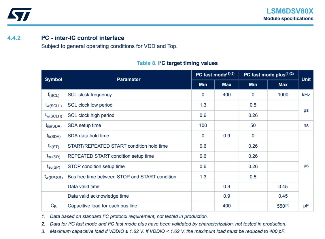

The module supports the following I²C communication speeds:
  • Standard mode: 100 kHz
  • Fast mode: 400 kHz

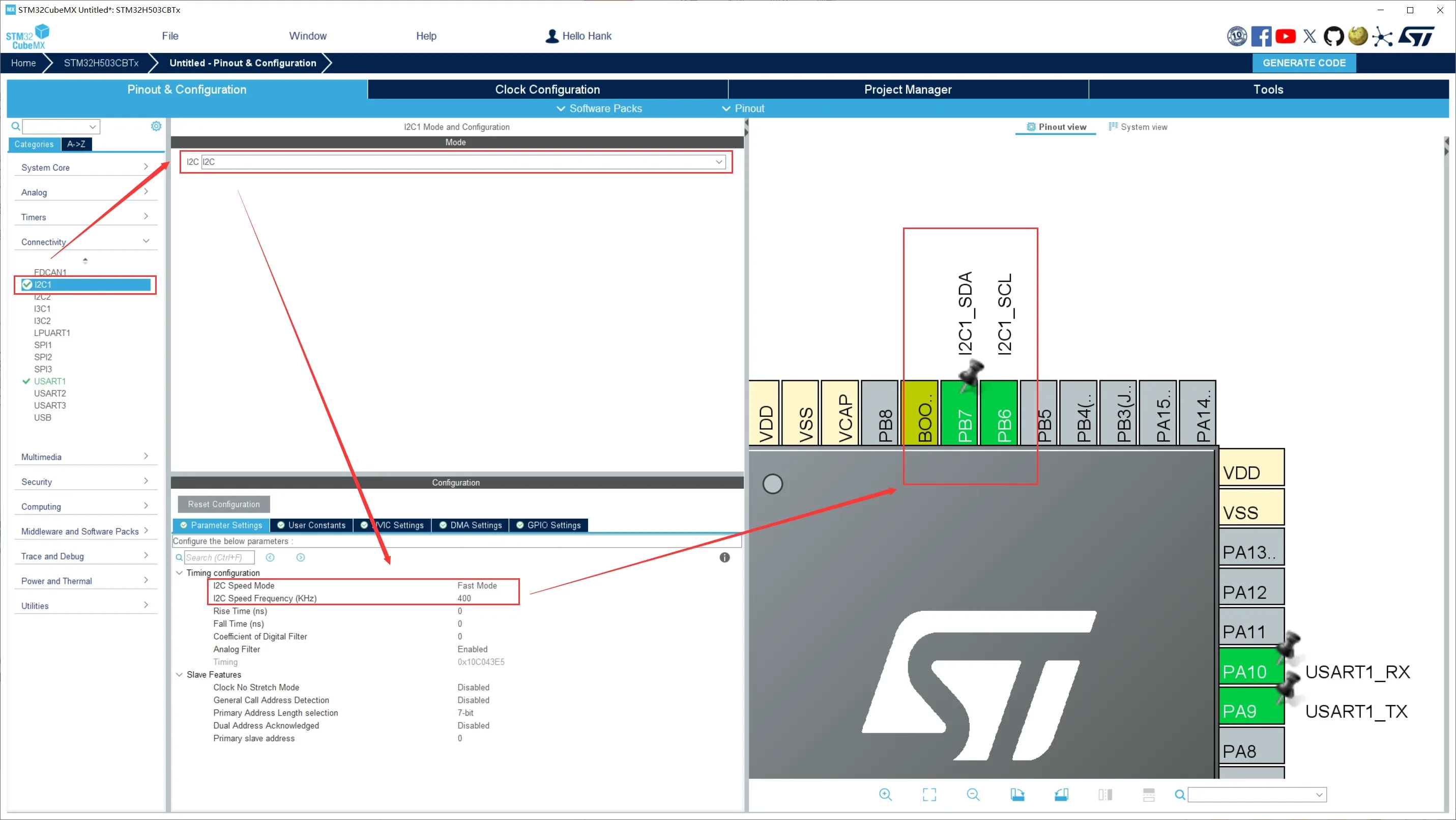

I²C Configuration
The LSM6DSV80X supports a maximum I²C communication speed of 1 MHz. In this example, the I²C bus speed is configured to 400 kHz.

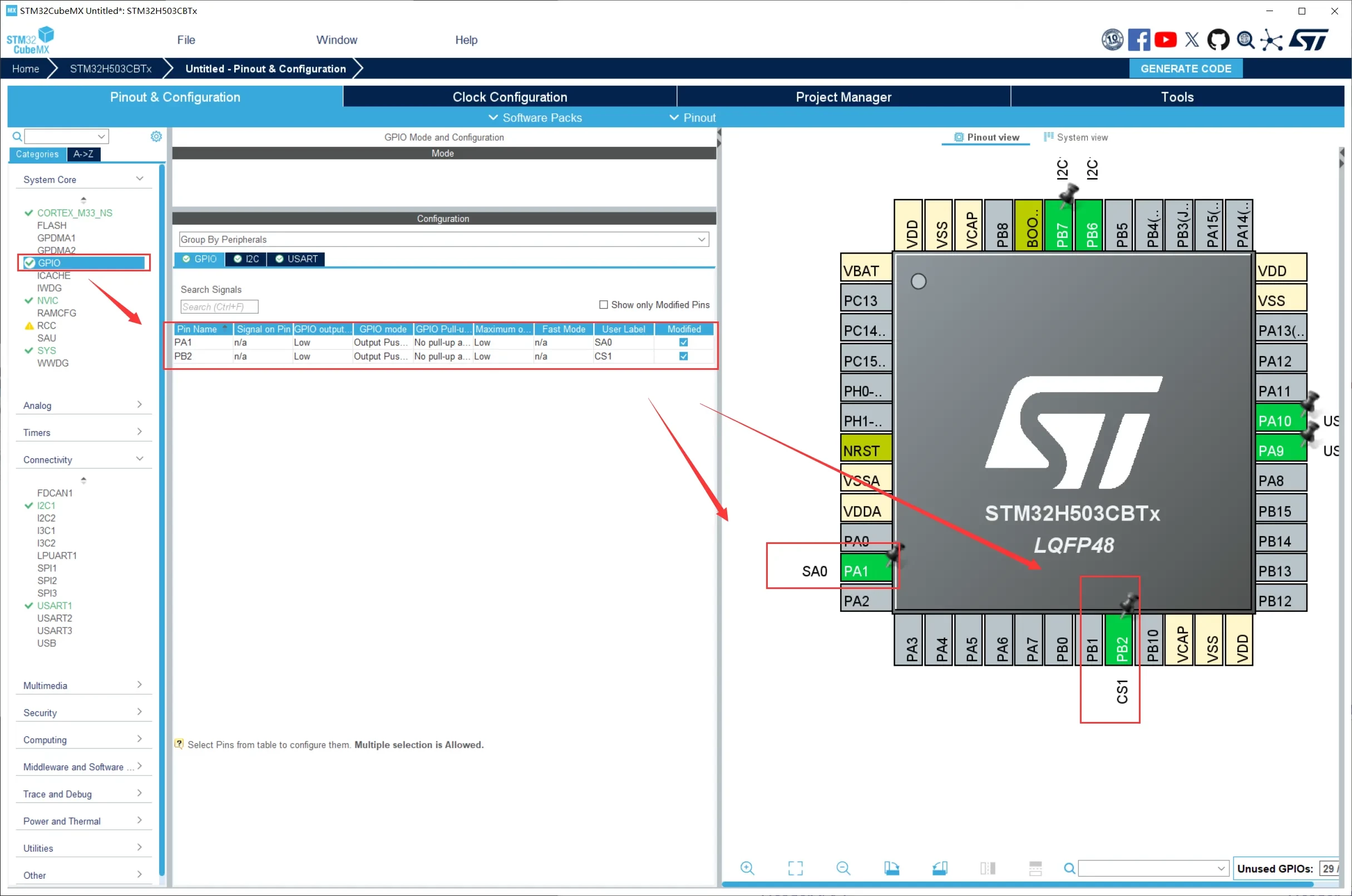

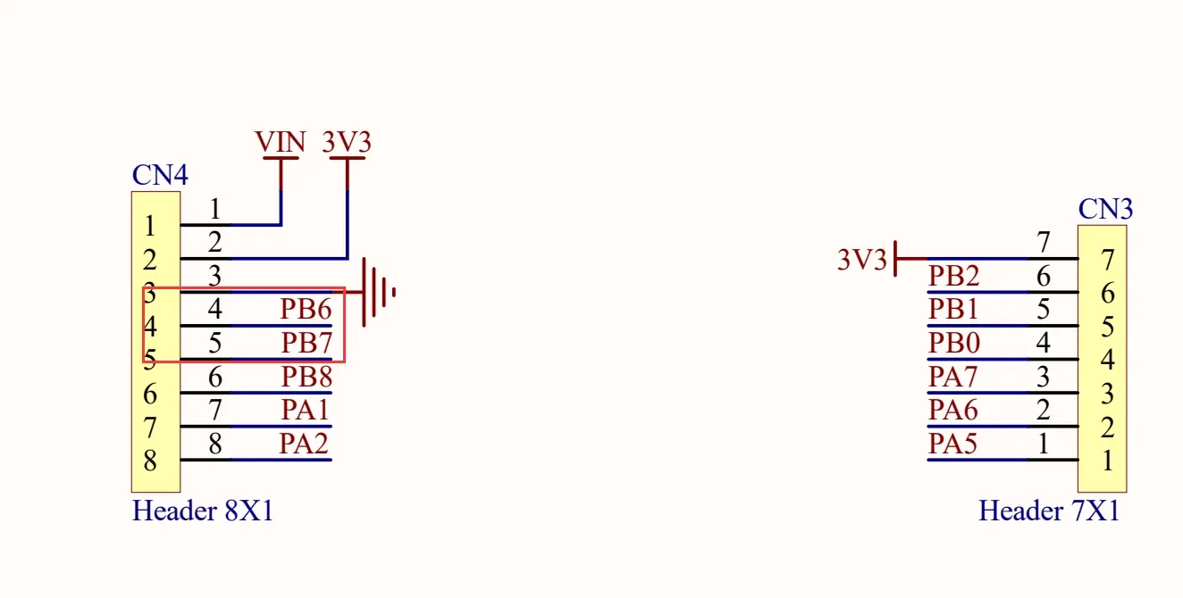

CS and SA0 Configuration
Since the board also includes a magnetometer, its CS pin must also be enabled and configured.

Pin Initialization
Since the LSM6DSV80X_I2C_ADD_L address is used and the device operates in I²C mode, configure the relevant pins as follows:
  • Set the CS pin high to enable I²C mode.
  • Set the SA0 pin low to select the LSM6DSV80X_I2C_ADD_L address.
	printf("HELLO!\n");
HAL_GPIO_WritePin(CS1_GPIO_Port, CS1_Pin, GPIO_PIN_SET);
HAL_GPIO_WritePin(SA0_GPIO_Port, SA0_Pin, GPIO_PIN_RESET);
HAL_GPIO_WritePin(CS2_GPIO_Port, CS2_Pin, GPIO_PIN_SET);
HAL_Delay(100);

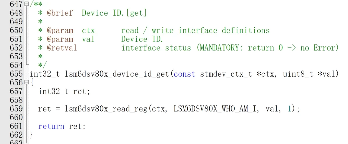

Reading the Device ID
Read the fixed value from the WHO_AM_I register (0x0F) and verify whether the returned value is 0x73.
Use the lsm6dsv80x_device_id_get() function to read the device ID.
The corresponding driver code for reading the device ID is shown below.
  /* Check device ID */
lsm6dsv80x_device_id_get(&dev_ctx, &whoamI);
printf("LSM6DSV80X_ID=0x%x,whoamI=0x%x",LSM6DSV80X_ID,whoamI);
if (whoamI != LSM6DSV80X_ID)
while (1);

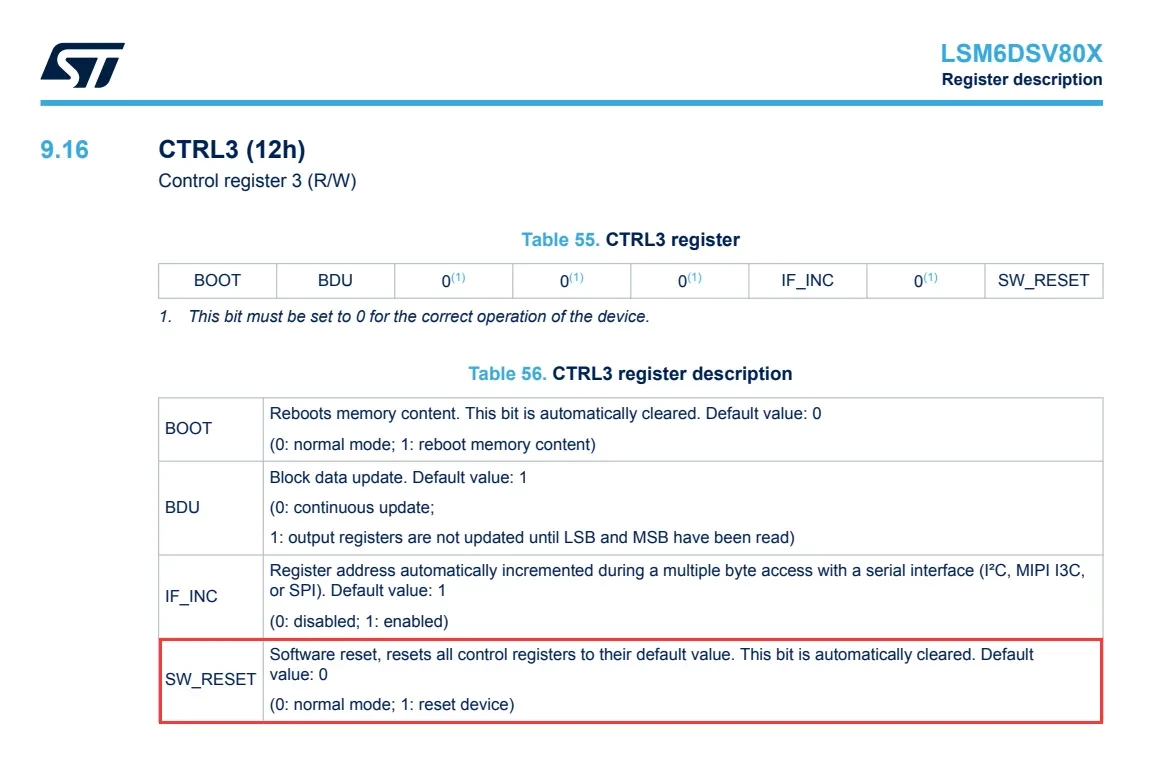

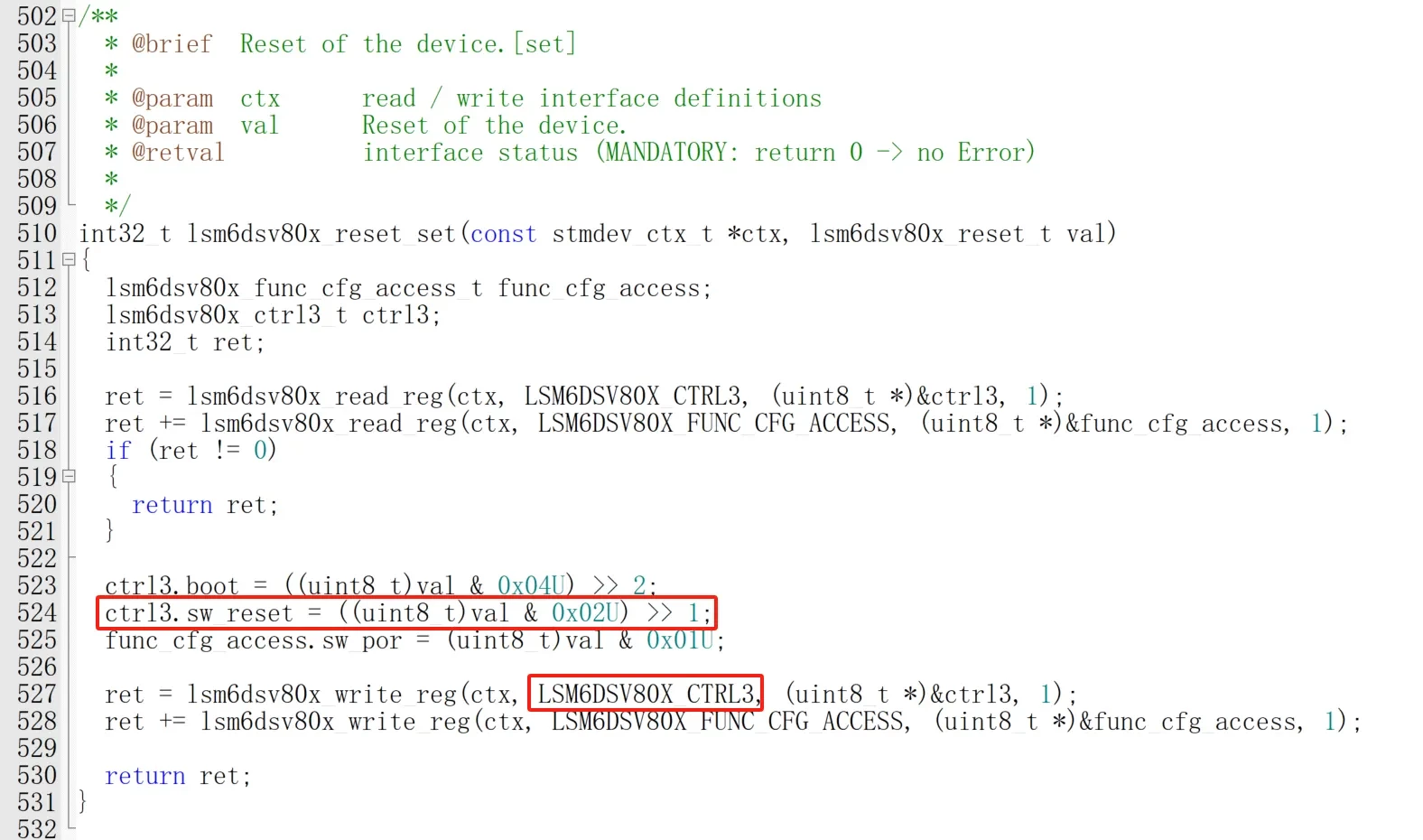

Reset Operation
Reset the device by writing 1 to the SW_RESET bit in the CTRL3 register (0x12).
Use the lsm6dsv80x_reset_set() function to reset the device.
The corresponding driver code is shown below.
  /* Restore default configuration */
lsm6dsv80x_reset_set(&dev_ctx, LSM6DSV80X_RESTORE_CTRL_REGS);
do {
lsm6dsv80x_reset_get(&dev_ctx, &rst);
} while (rst != LSM6DSV80X_READY);

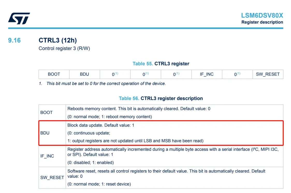

Block Data Update (BDU)
In many sensors, measurement data is stored in output registers that are divided into two parts: the Most Significant Byte (MSB) and the Least Significant Byte (LSB). These two bytes together represent a complete measurement value. For example, in an accelerometer, the MSB and LSB together represent one acceleration sample.
Continuous Update Mode (BDU = 0)
By default, the output registers are continuously updated with new measurement data. As a result, while the MCU is reading the MSB and LSB, the sensor may update the registers with a new sample.
This can lead to inconsistent data. For example, the MSB may belong to the previous sample, while the LSB belongs to the next sample. The combined result does not represent any valid measurement and may introduce errors.
Block Data Update Mode (BDU = 1)
When the BDU function is enabled, the output registers are locked during the read operation. Once the MCU starts reading either the MSB or LSB, the register contents remain unchanged until both bytes have been read.
This guarantees that the MSB and LSB belong to the same measurement sample, ensuring data consistency and preventing corrupted or mixed readings.
In short, enabling the BDU function ensures that the output registers remain stable during a read operation, preventing inconsistent data. This feature is especially important in applications requiring high accuracy and reliable measurements.
To enable BDU, write 1 to the BDU bit in the CTRL3 register (0x12).
