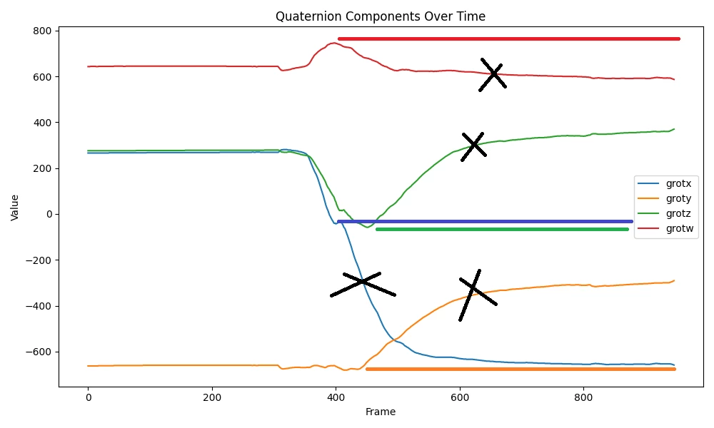

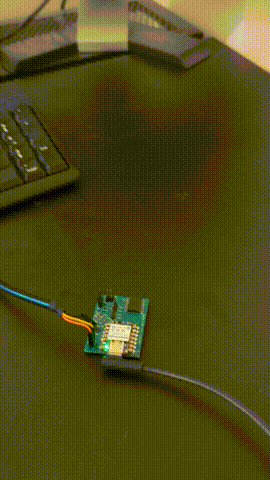

Hi, I am using the LSM6DSV16BX IMU on a project where I need the Game Rotation data.
I used the Github examples as a base, and reading the Game Rotation values works well and I am able to save the quaternion data in a file. I wrote a little script that takes the Game Rotation quaternion values and applies the orientation to an object, to mimic what is possible in Unico GUI with STEVAL-MKI234, however I do not get the same performance with my custom board. For instance, I sometimes get some weird rotations around two axis even though I rotate the device around a single axis. See video:
I was wondering if any special setup was required to achieve this kind of performance ? Is there any calibration that can be made ?
I configure the Accelerometer and gyroscope to 960Hz, but batch samples of Accelerometer, Gyrometer and Game Rotation data at 120Hz in FIFO. I realize this is not much information to try and help me, I am more than happy to provide more detailed information if needed, any advice is appreciated.

Oct 2, 2025 6:00 PM UTC

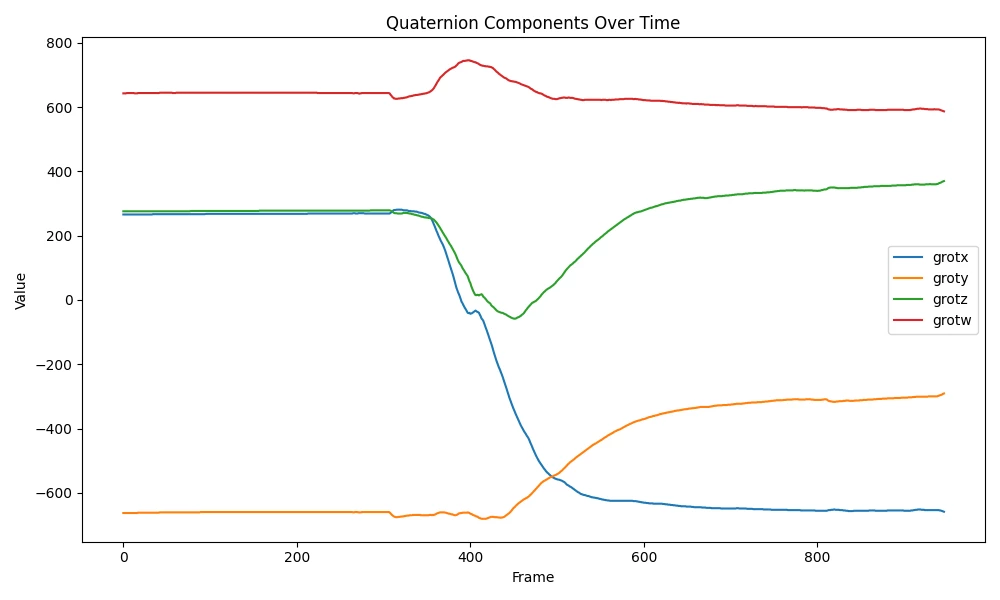

To recap my issue (as after reading my first post it did not seem super clear...), here is a video of the movement I apply to the device:
Here is a plot of the quaternion data I read from the device corresponding to this movement:Quaternion.png

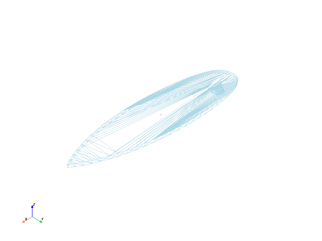

I have a script that displays a 3D model of a surfboard and orients it according to the received data, which looks like what is in my original post. You can see rotations around two axis, where I only rotate the device around one axis.
I would have expected the graphs to look like this:
That is, the quaternion data stabilizes after the move. It is what I observe when using Unico and the STEVAL MKI234AA.
I did some more tests to try to understand what I could have done wrong, in particular I exported the configuration from Unico and applied it to my device. The configuration I used is the following:
