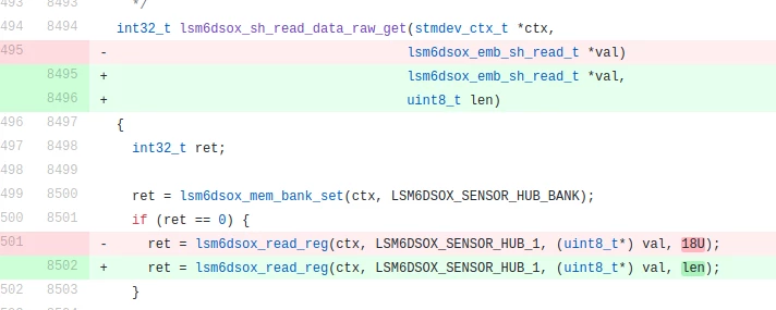

One of my previous post the driver for the sensor lsm6dsox hub mode 2 configuration, I have written that the function lsm6dsox_sh_read_data_raw_get was not working correctly. I managed to fix it.Now I see someone fixit
Now I'm using lsm6dsr and the same function lsm6dsr_sh_read_data_raw_get needs to add the length.
And also this needs to be changed
typedef enum {
LSM6DSR_EXT_ON_INT2_PIN = 0,
LSM6DSR_XL_GY_DRDY = 1,
} lsm6dsr_start_config_t;
to
typedef enum {
LSM6DSR_XL_GY_DRDY = 0,
LSM6DSR_EXT_ON_INT2_PIN = 1,
Please can someone check and confirm.

Hi @suads​ ,
I think you are right, but let me please submit it internally to our experts.
Thank you for your bug reporting, also for the last time I didn't do the follow-up.
-Eleon

Hi @suads​ ,
back to you again. Our experts suggestion is to directly open an issue or a pull request on the LSM6DSR or LSM6DSOX Github folder: every week all the open points will be validated and typically on Friday they'll be closed.
But ok, for this time no problem, the bug has been reported.
