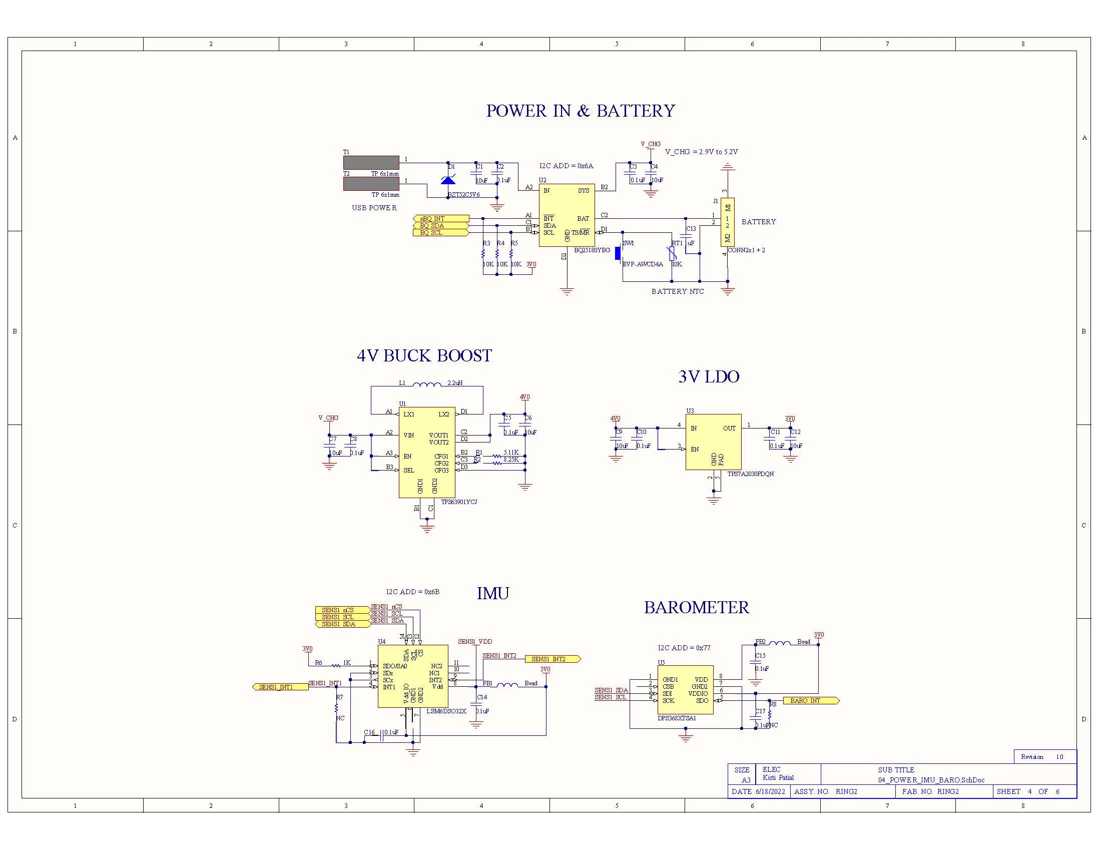

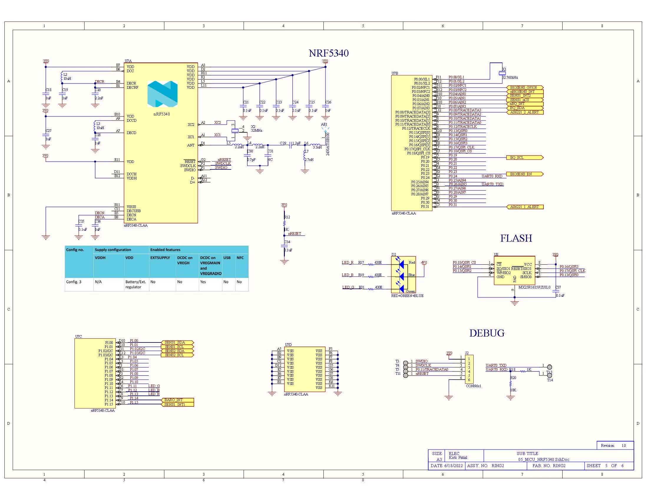

LSM6DSOX schematics verification. We are unable to detect the LSM6DSOX IC address. We used the same IC with CS as 3.3v and we could detect it. In this device we are making CS high to 3.3V via Nordic SoC pin P0-5. We checked the voltage at the Pin as

    Hi @plawat​ ,
    are the Vdd, VddIO and CS high state (and in general the digital communication lines) all at 3.3V?
    -Eleon

    Hi Eleon, there is 3v​ to Vdd via bead, 3v to VddIO and 3 v to CS as seen in schematics
