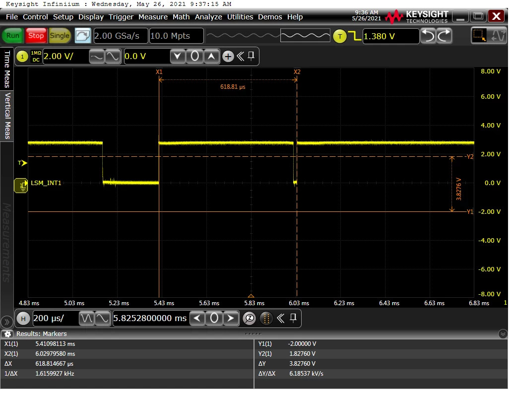

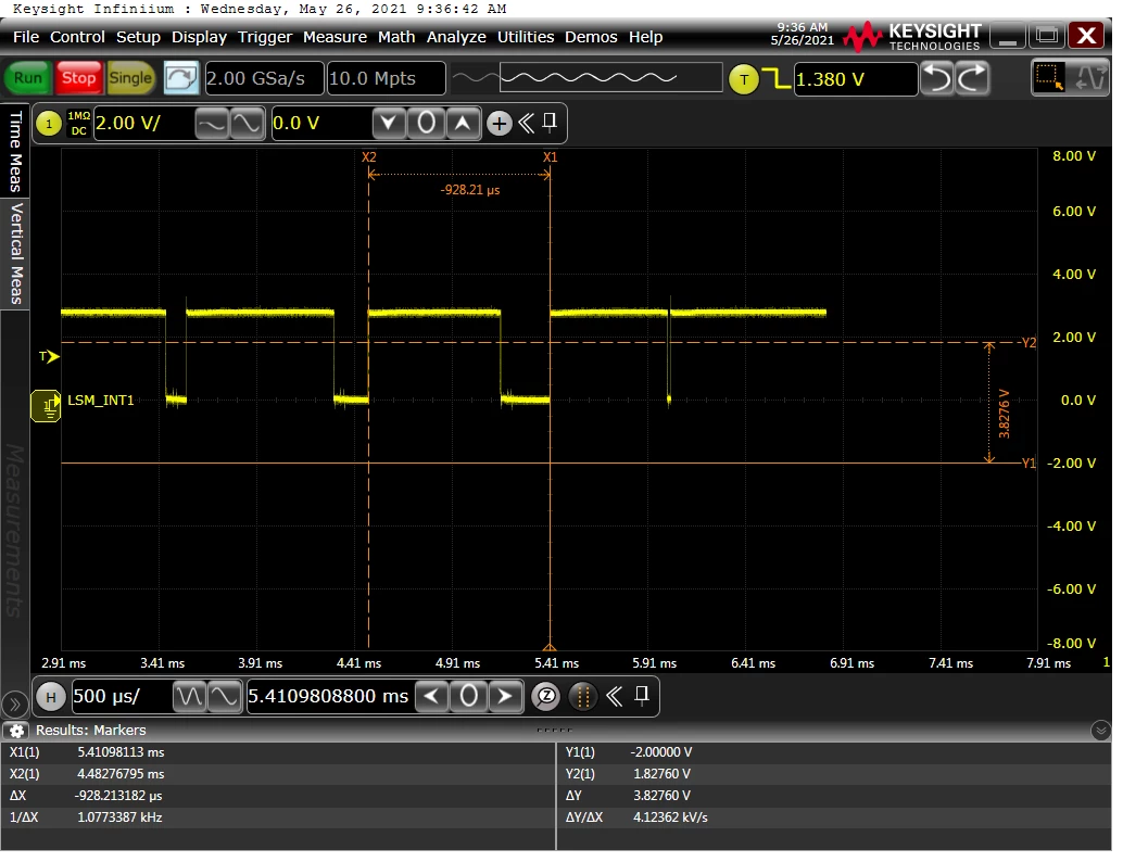

I want to read sensor data periodically in interrupt mode.
And sensor is configured like below code.
 /* Set Output Data Rate */
 lsm6dsox_xl_data_rate_set(&lsm_ctx, LSM6DSOX_GY_ODR_3333Hz);
 lsm6dsox_gy_data_rate_set(&lsm_ctx, LSM6DSOX_GY_ODR_3333Hz);
/* Enable interrupt generation on Inactivity INT1 pin */
 lsm6dsox_pin_int1_route_get(&lsm_ctx, &int1_route);
 int1_route.drdy_xl = PROPERTY_ENABLE;
 lsm6dsox_pin_int1_route_set(&lsm_ctx, int1_route);
But int1 pin is measured as 1kHz or 1.6kHz
0693W00000APnfXQAT.png0693W00000APnfSQAT.pngHow could Int1 Pin change Low to High every 3333Hz?
1 reply
niccolò
May 27, 2021
Hi @Community member​ ,
it seems that the interrupt is not configured right.
can you check the status of bit INT1_DRDY_XL in register INT1_CTRL (0Dh)?
also, is your interrupt latched or not?
(check bit LIR in register TAP_CFG0 (56h))
Niccolò
