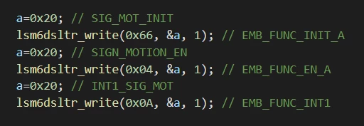

LSM6DSOTR- Minimum motion on INT1 to generate an interrupt?
What registers do we need to set to generate the minimum motion interrupt on INT1? The picture included contains what we have tried so far. 0693W00000D1QCWQA3.png

Hi, it depends on the interrupt you want to rise. In any case, the minimum signal that can raise a specific interrupt is the LSB of that particular interrupt's threshold. For example, the minimum threshold for wakeup is: 1 LSB weight depends on WAKE_THS_W in WAKE_UP_DUR (5Ch). For the TAP feature, the register is the TAP_CFG1 (57h) (only 5 bits, 1 LSB = FS_XL / (2^5) ).
The typical formula is 1 LSB = FS_XL / (2^N_thres_bits)
https://www.st.com/resource/en/datasheet/lsm6dso.pdf
Tom
