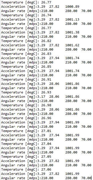

LSM6DSO32X output data is it right?
I used the lsm6dso32x_read_data_polling example and got the same result as above.(with SPI)
Is this the correct value?

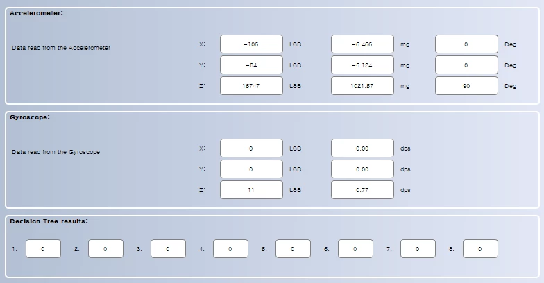

And when I checked the values ​​using Unico GUI tool, I got the same values ​​as above.
Although the values ​​are similar to the example, they are slightly different. So I'm a little confused. Is this okay?
Thank you.
Federica Bossi
Federica BossiBest answer
November 22, 2023
Hi @sygo ,
Your data seem ok, I don't know in which position you had the sensor but they make sense.
The little difference between the two measurements can be due to little movements between the first and the second one.
