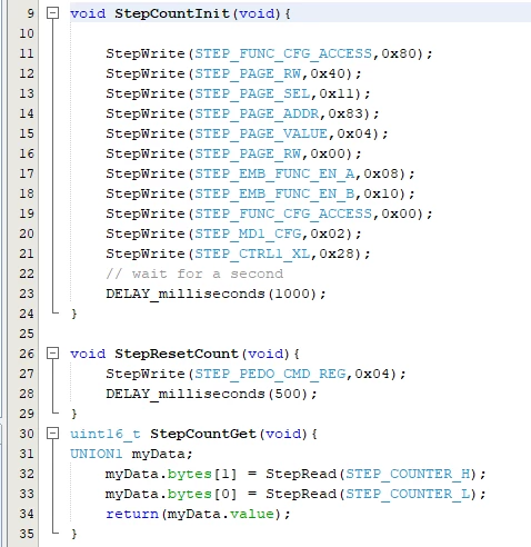

I designed a special board that includes the LSM6DSO32 sensor. I want to get step count data, for testing I am using ESP32-CAM with LSM6DSO32 via I2C. I have followed the basic routine mentioned in application notes. I can get only garbage value. I will attached sample code for reference. Can you check and help me step by step what to do? First code give step count 0 always. For second code I attached screenshot. Please look into it and tell if anything need to change.

I would appreciate if you some ways to get step count data, that would be great.
Thanks You

Federica Bossi
March 12, 2025
Hi @rex2 ,
Can you try this code and let me know if you get consistent data?

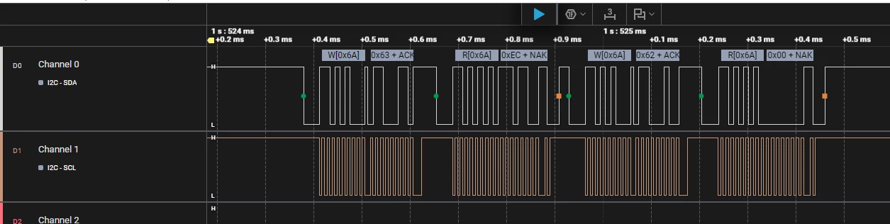

Hi Federica
I have essentially the same code as above, however its being run on a Microchip MCU in C.
In my code I initialize the IC, then wait 1second, reset the count, wait 100ms and then read the count.
When I read the count I get consistently EC 00
Do you see any error in what I am doing
