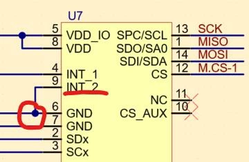

LSM6DSO32 INT2 Pin to the GND?
Hi, in my application I will not use INT2 pin. Is it okay to connect INT2 pin to the GND?0693W00000aJTRmQAO.jpg

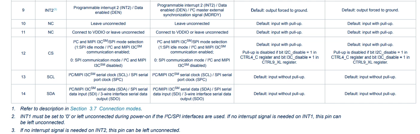

    Hi @Eleon BORLINI​
    https://www.st.com/resource/en/application_note/an5473-lsm6dso32-alwayson-3d-accelerometer-and-3d-gyroscope-stmicroelectronics.pdf
    According to this application note, INT2 default is output forced to the ground
    0693W00000aJkQMQA0.pngso Is it okay ?

    Eleon BORLINI
    March 24, 2023
    Hi @Egemen​ ,
    yes you can, INT2 is by default in high impedance state.
    -Eleon

    Eleon BORLINI
    March 28, 2023
    Hi @Egemen​ ,
    you are right, in my mind I was thinking that could be left unconnected, and I wrote high impedance.
    It is ok as well.
