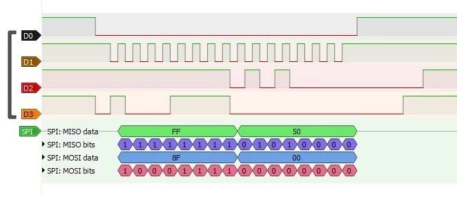

Good morning,
I am trying to read the WHO_AM_I register from LSM6DSO, but it doesn't respond as needed. I will attach a picture from signal analyzer (D0 is CS, D1 is CLK, D2 is MISO, D3 is MOSI). It looks like its respond is 0x50 instead of 0x6C. What should I change?
I tried with a MAX32630 and it was working (8 bits transfer mode).
When I try with RS14100 (16 bits mode) it responds with 0x50 instead of 6C.
Gabriel

gabriel.arnautu
January 24, 2019
It looks like if I am using 1.8V it returns 0x6C which is correct. Does that makes any sense?
gabriel.arnautu
January 24, 2019
I finally found the problem. I was using 1.8V for communication, but my VDDIO was connected to 3.3V

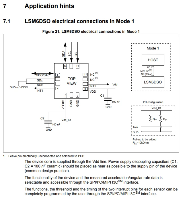

Eleon BORLINI
January 25, 2019
​hi Gabriel, did you follow all the Mode1 electrical connection suggestions?
And is this error still related only to RS14100 device? Could you set 8bit communication instead of 16bit on your master?
