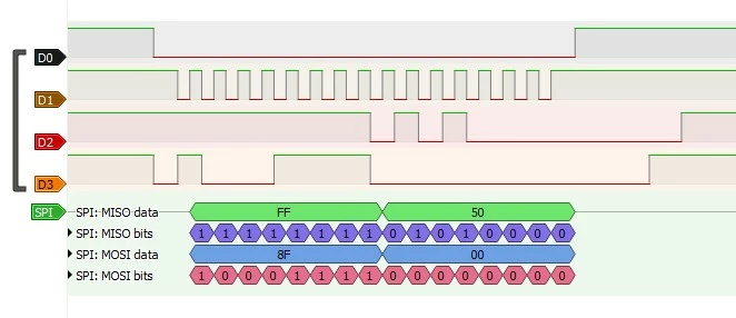

Good morning,
I am trying to read the WHO_AM_I register from LSM6DSO, but it doesn't respond as needed. I will attach a picture from signal analyzer (D0 is CS, D1 is CLK, D2 is MISO, D3 is MOSI). It looks like its respond is 0x50 instead of 0x6C. What should I change?
I tried with a MAX32630 and it was working (8 bits transfer mode).
When I try with RS14100 (16 bits mode) it responds with 0x50 instead of 6C.
Gabriel

    S.Ma
    Principal
    January 24, 2019
    If it is still the same as before, MEMS start in SPI 3 wires. First write the control register to go to 4 wires, then read back the WHO_I_AM, or manage the SPI 3 wire by shorting MISO and MOSI on the same line.
