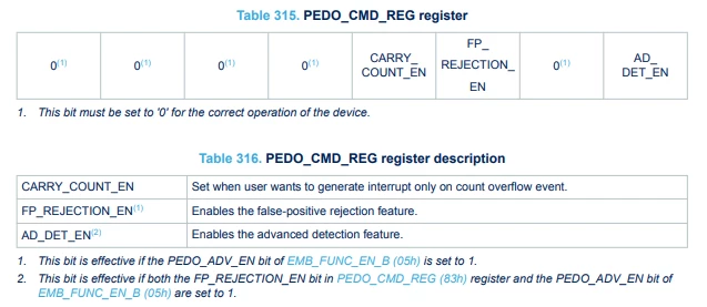

LSM6DSO pedometer setting
Now I am using LSM6DSO sensor pedometer function. I found it is too sensitive and want to change it. I found four pedometer settings. They are ****_CMD_REG, ****_DEB_STEPS_C, ****_SC_DELTAT_L, ****_SC_DELTAT_H. I can just understand the function of the second one. Can you explain the other three meaning? I have changed them and will cause the pedometer stop.

Hi @JXiao.1​ ,
  • The ****_CMD_REG is the Pedometer configuration register and is described below [description in datasheet, p. 134].0693W000006GSRVQA4.png
  • The ****_SC_DELTAT_L and the ****_SC_DELTAT_H are two parts of a unique parameter, 16-bit unsigned value with a resolution of 6.4 ms. It can be used in conjunction with the STEP_COUNT_DELTA_IA bit of EMB_FUNC_SRC registers: enabling this bit, instead of generating an interrupt signal every time a step is recognized, it is possible to generate it if at least one step is detected within a certain time period, defined by setting a value different from 00h in those registers. Note that, in addition, it is necessary to set the TIMESTAMP_EN bit of the CTRL10_C register to 1 (to enable the timer). you might act on this register to modify the pedometer sensitivity [description in AN5192, p. 57].
Let me please know if these indications can help you.
-Eleon
