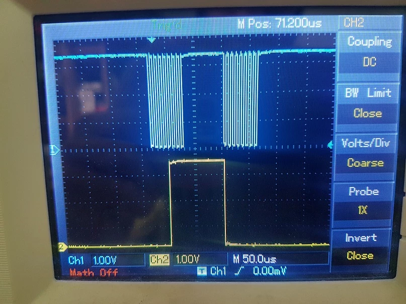

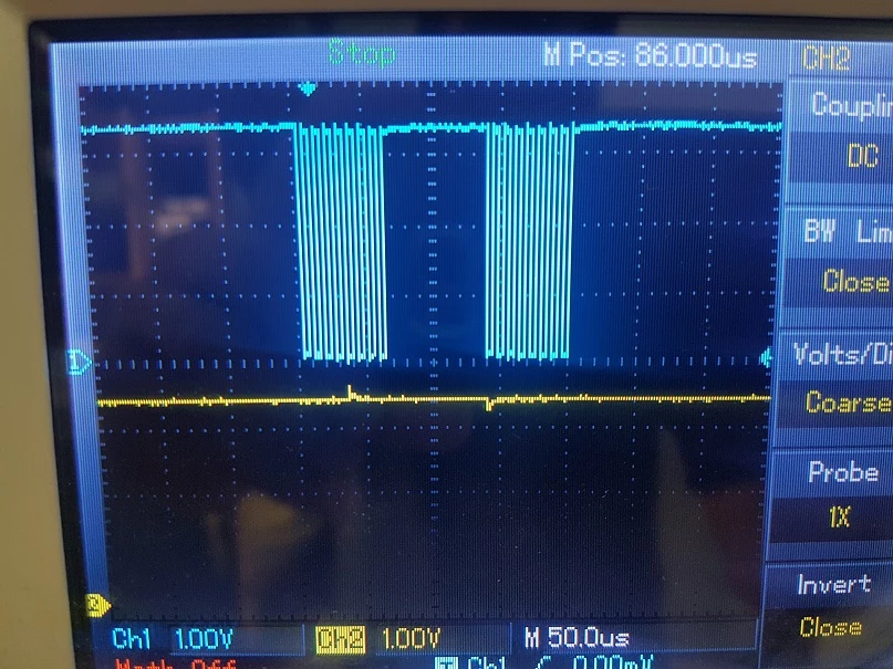

    Hi @Yiftah​ , ok I understand... when you write >>SPI signals look fine in the oscilloscope, which is the pattern on SDO_Aux pin? Regards
    Yiftah
    YiftahAuthor
    April 16, 2020
    Hi @Eleon BORLINI​ ,
    SCLK (pin 3) + MOSI (pin 2):
    SCLK (pin 3) + MISO (pin 11):
