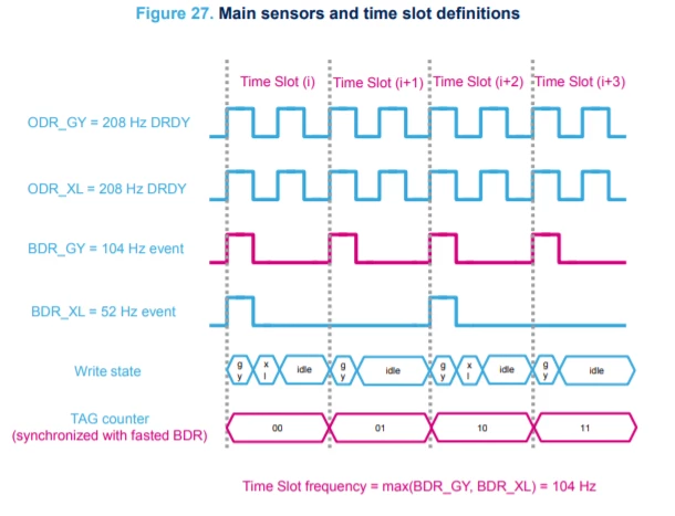

They store data in separate arrays, acc_data[] and gyr_data[] each of them includes a timestamp. What is the way to store data in one array which includes a timestamp, accelerometer X,Y,Z and gyroscope X,Y,Z data? I need to store samples matching the same timestamp. Do you have such an example? Thanks!
Eleon BORLINI
April 30, 2021
Hi @BDiva.1​ ,
now you are considering the compression code, right?
If so, the timestamp is defined as:
// Axl
fifo_out_slot[j].timestamp =
 (timestamp - (2U * TIMESTAMP_FREQ / (uint32_t)bdr_xl));
//Gyro
 (timestamp - (2U * TIMESTAMP_FREQ / (uint32_t)bdr_gy));
If you choose the same Batch data rate [Hz] for both accelerometer and gyroscope, you'll capture and store data at the same time so you'll have the same timestamp.
An example of the timings between data is described in the application note AN5192, p.94:
0693W00000AMxvAQAT.pngHowever, for a more detailed question I suggest you to post it in the "Issue section" on Github, that is periodically updated by ST experts.
