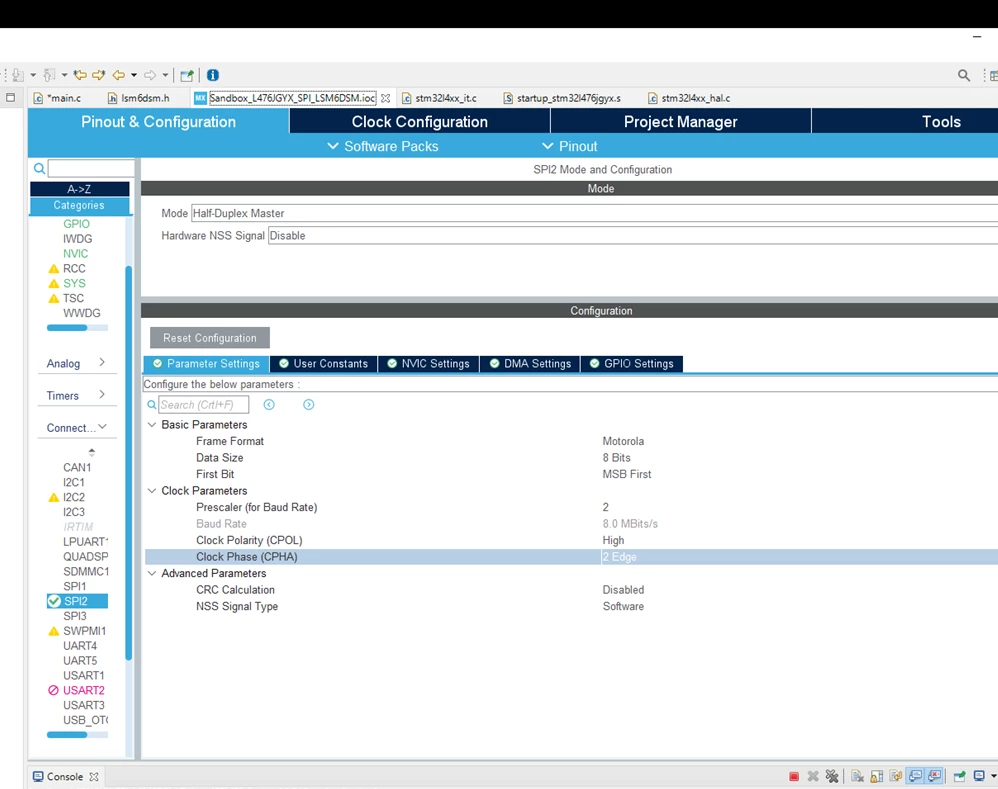

I would like to know what I am doing wrong or what register setting on the LSM6DSM that I missed setting?
Using a sensorTile (STM32L476JG) that is connected to LSM6DSM. APB1 Clk = 16MHz.
My settings are :
My code is trying to read WHO_AM_I register on the part, I get 0xC5 , should get 0x6A.
	 HAL_GPIO_WritePin(SPI_CS_GPIO_Port, SPI_CS_Pin, GPIO_PIN_RESET);
	 txBuf[0] = 0x12;
	 txBuf[1] = 0x08;
	 HAL_SPI_Transmit(&hspi2, txBuf, 2, 50);
	 HAL_GPIO_WritePin(SPI_CS_GPIO_Port, SPI_CS_Pin, GPIO_PIN_SET);
	 * disable i2c
	 txBuf[0] = 0x13;
	 txBuf[1] = 0x04;
	 * who_am_I : should return 0x6a
	 txBuf[0] = 0x0F | 0x80;
	 HAL_SPI_Transmit(&hspi2, txBuf, 1, 50);
	 HAL_SPI_Receive(&hspi2, rxBuf, 1, 50);

By the way, are you always getting I get 0xC5 instead of 0x6A? Did you try to read other registers (such as the output regs after having configured at least the ODR in the control registers?)
-Eleon

Thank you. I am not reading C5 consistently.....Sometimes 0xC5 sometimes 0x09....Never 0x6A. I did try to write a value to 0x25 to 0x71 address as well and there I receive back 0x09....I feel like I am missing some initializations on the LSM6DSM register settings?? As you can see I am setting register 0x12 (although I have no way to confirm that these writes are working......) which should set me for 3 wire SPI and register 0x13 which should disable I2C.....

but are you using the 3-wire SPI instead of the 4-wire standard? IN the first case you have to properly manage the SDI/O line, and also to write the SIM bit of the CTRL3_C (12h) register (but, if the SPI is not working, this action would not be possible).

Note that if you want to read the WHO_AM_I register, you don't need a specific register setting, but only to initialize correctly the pins (Vdd, VddIO, SPI, GND).
Could you try to setup the SPI-4 communication?
