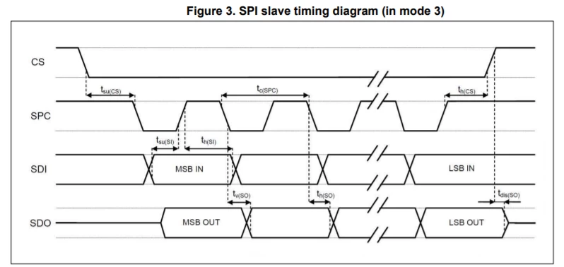

Hello....
I am trying to communicate with the above subject but I am not sure what CPOL and CPHA should be set to. STM uses MODE1 - 4 but SPI talks about MODE 0 - 1. I have the following basic code to just try and read the WHO_AM_I Register (0x15) which should return 0x6A. I am using an ST sensortile which is too small to get a logic analyzer on it to see what is going on. My code is pretty basic....I have tried all the variants of CPOL and CPHA and only get 0 or 255 back. Can someone please tell me what I am doing wrong? (using an STM32L476JG)

Hi @SWenn.1​ ,
As shown in the datasheet p, the working SPI Mode is Mode 3, i.e. with CPOL=1, CPHA=1:
By the way, can we refer to this more recent question for this topic's discussion?
