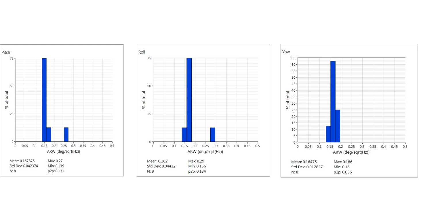

Angular random walk of gyroscope:

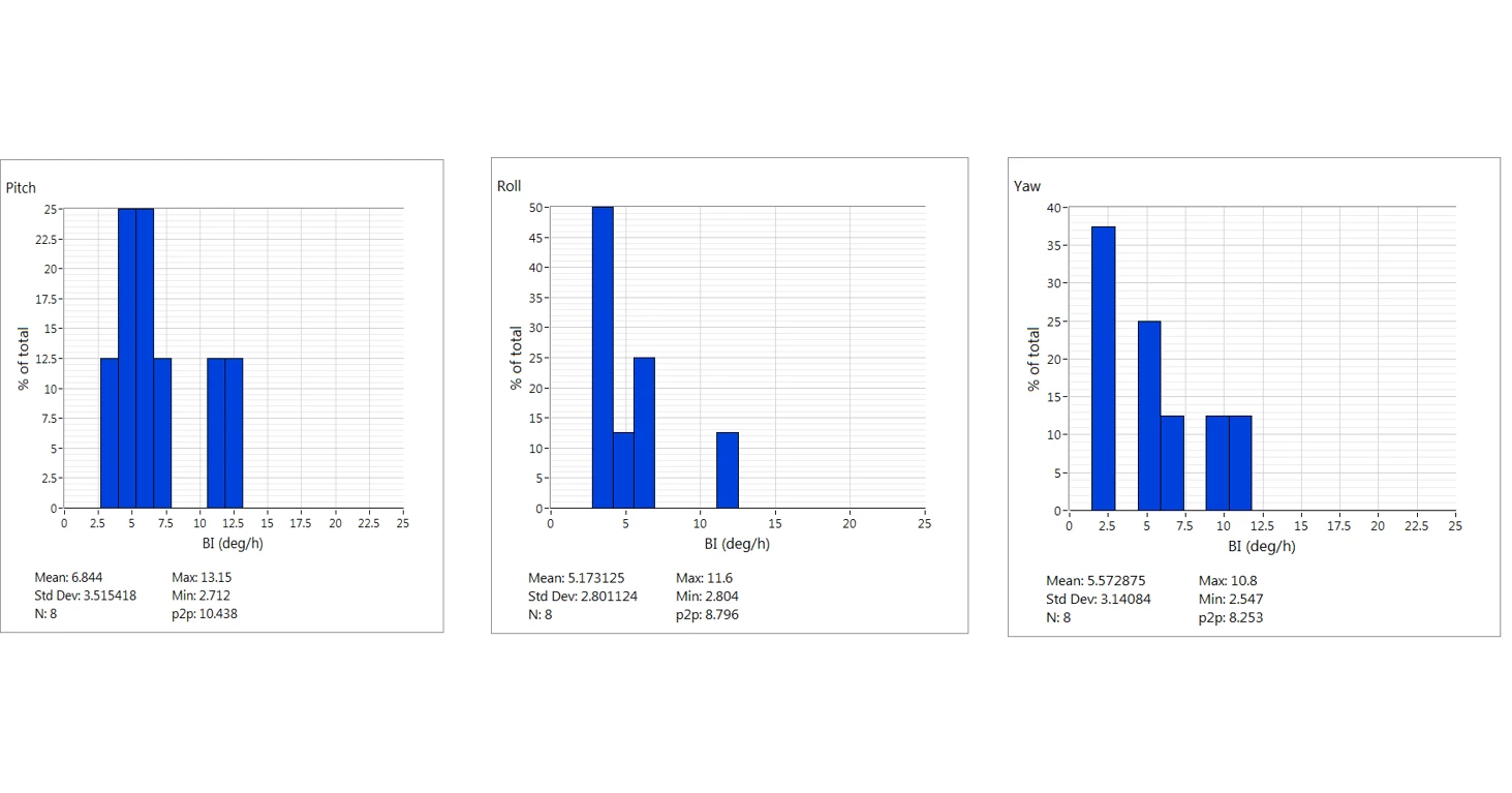

0693W000007ZjWoQAK.pngBias stability of gyroscope:
0693W000007ZjWyQAK.pngIf my reply answered your question, please click on Select as Best at the bottom of this post. This will help other users with the same issue to find the answer faster.

Is there a unit problem of Angular random walk of gyroscope in your answer ?
I expected the data in "deg/s /sqrt(Hz))" or in deg/sqrt(h) ?

About the "acceleration bias repeatability" parameter you might consider the standard deviations shown in the above picture: they accounts for a confidence interval of

Is there a unit problem in the Angular random walk of gyroscope ?
I expected a value in °/s /sqrt(Hz) or in °/sqrt(h) ?
Eleon BORLINI
Mar 23, 2021 4:01 PM UTC
Hi @NPoth.1​ ,
yes, you are right, there is a typo in the pictures above.
Thank you for the notification.
