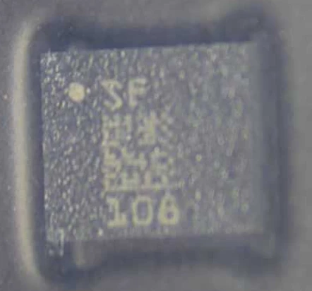

LSM6DSLTR device marking
Hi!
Our incoming inspection unit failed to find any information on LSM6DSLTR device marking. We got parts with 2 lines on it.
SF
2D code
106
Could you please confirm it is a LSM6DSLTR device? Is there date code on it?

    Yes, SF designates the LSM6DSL.
    The date code is given in the last line, 106 stands for 2021, week 6.

    Hi! Peter!
    Thanks a lot! Have a nice day!
