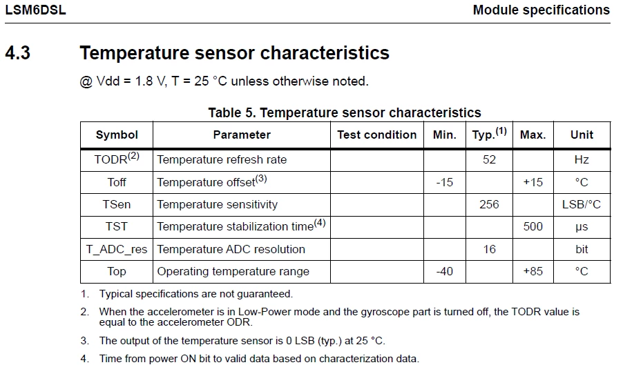

We have several units of LSM6DSL in the field and I was looking that this part has an embedded temperature sensor. I would like to understand better the accuracy of this sensor. The datasheet is not clear, showing only this information.
Can I assume the operational range of this sensor is the same as the device (Top = -40~85ºC)?
The datasheet says OFFSET -15/+15 ºC. Is this the accuracy of this sensor?
 Since is 16bits for ADC resolution, the minimal step will be 1/256 ºC. And the range will read 25ºC +/- 127ºC?

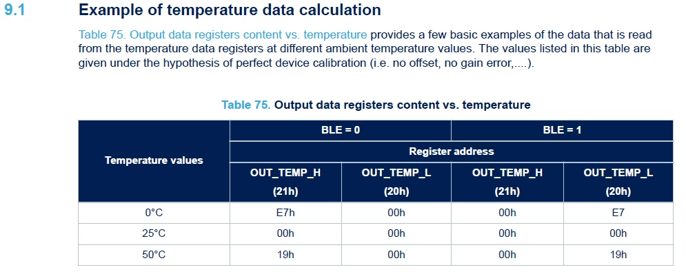

The AN5040 shows a table of example values
Considering these values looks like each degree are part of the 8bit register, making 1bit/ºC and with integer values. Can anyone help me understand that?

    Hi @RNJ​ ,
    Welcome to ST Community!
    About your first question: yes, the operational range is -40-85°C.
    The datasheet says OFFSET -15/+15 ºC. Is this the accuracy of this sensor? No, this is the max an min offset meaning that if the room temperature is 25 degree the sensor can show 25+15 °C. Since this is an offset, it can removed by performing a calibration.
    In this case, if you are compensating the offset, considering that the LSB value is 1/256°, you could have an accuracy of about +-1.5°C across the +-1°C interval.
    Hope this helps.
