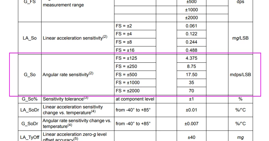

When using lsm6dsl_reg driver files I've stumbled on the following angular velocity conversion macros.
The math seems wrong...
Can ST verify this?
Thanks
#lsm6dsl_reg
    1 reply
    April 4, 2018
    Posted on April 04, 2018 at 17:36
    You are right, there is a mistake.
    It should be following:
    #define LSM6DSL_FROM_FS_125dps_TO_mdps(lsb)    (float)(lsb *
    4375.0f
    ) / 1000.0f
    #define LSM6DSL_FROM_FS_250dps_TO_mdps(lsb)    (float)(lsb *
    875
    0
    .0f
    ) / 1000.0f
    #define LSM6DSL_FROM_FS_500dps_TO_mdps(lsb)    (float)(lsb * 1750
    0
    .0f
    ) / 1000.0f
    #define LSM6DSL_FROM_FS_1000dps_TO_mdps(lsb)   (float)(lsb *
    35.0f)
    #define LSM6DSL_FROM_FS_2000dps_TO_mdps(lsb)   (float)(lsb *
    70.0f)
    We will fix it asap.
