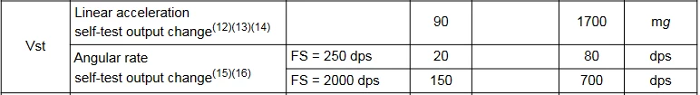

Hello everyone,
I am currently trying to use a LSM6DSL (accelerometer and gyroscope) but only the accelerometer works.
I am using a NUCLEO-L476RG with a LSM6DSL from a STEVAL-MKI178V2 with the st library : lsm6dsl.c/h and lsm6dsl_reg.c/h
After the init I get the correct values from the acc but not from the gyro (out of scale values when I am expecting close to 0).
So I have implemented the self tests given int he application notes (attached file) p.96-99.
The accelerometer passes its test but not the gyroscope, which have deltas over 300K dps.
Here is my gyro's self-test :

if((abs(axes_delta.x) >= 150) && (abs(axes_delta.x) <= 700) && \
(abs(axes_delta.y) >= 150) && (abs(axes_delta.y) <= 700) && \
(abs(axes_delta.z) >= 150) && (abs(axes_delta.z) <= 700))
status = true;

I seriously doubt that the hardware is the issue as the acc is perfectly fine.
Can anyone help me ?
Don't hesitate to ask me if I have forgot any information.
