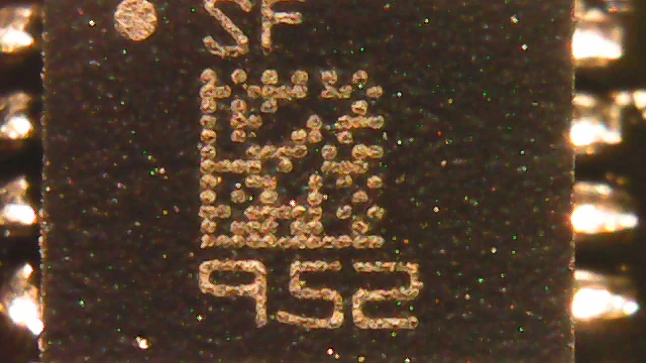

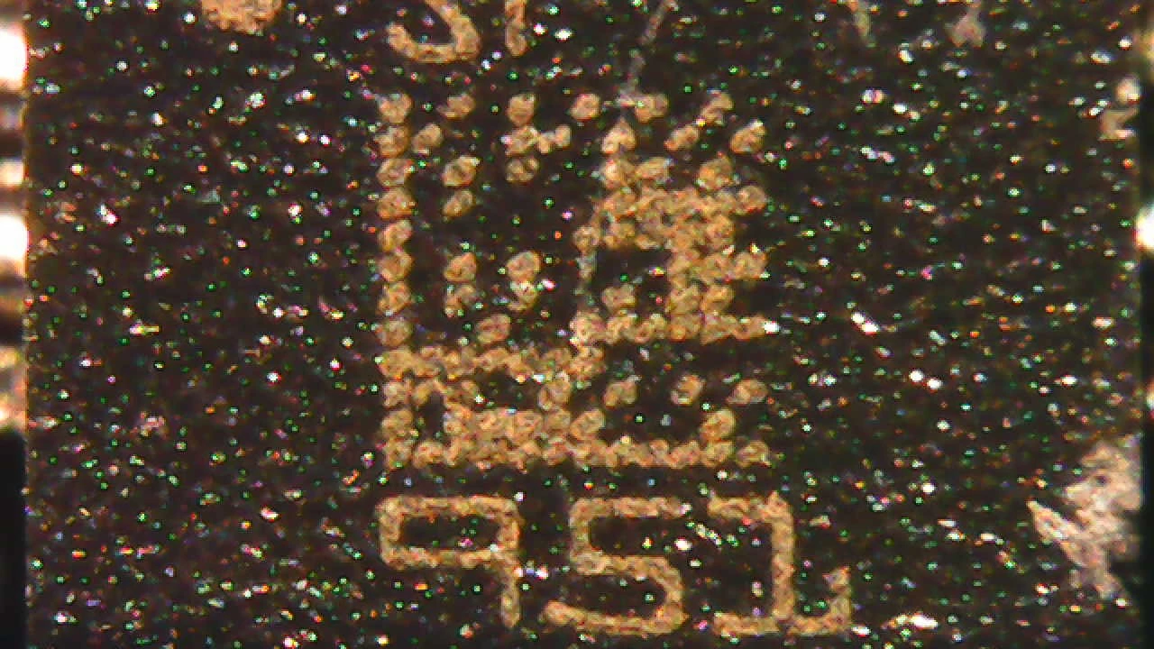

I am using the LSM6DSL, i can see that the chip marking is different for some of my chips,
some have SF 951 and others have 952.
Further, I am getting different sensor results from each,
Does someone know what is the difference between them?
Thanks

    Most likely a production code
    Do you have any of the materials they shipped with?
    What are the register settings/content?
    All devices apt to report somewhat differently.

    Hi @GORDI​ ,
    SF is the code for the LSM6DSL, while 951 and 952 means assy in wk 51 (or 52) of 2019 ("9").
    In which sense are you getting different results between them?
