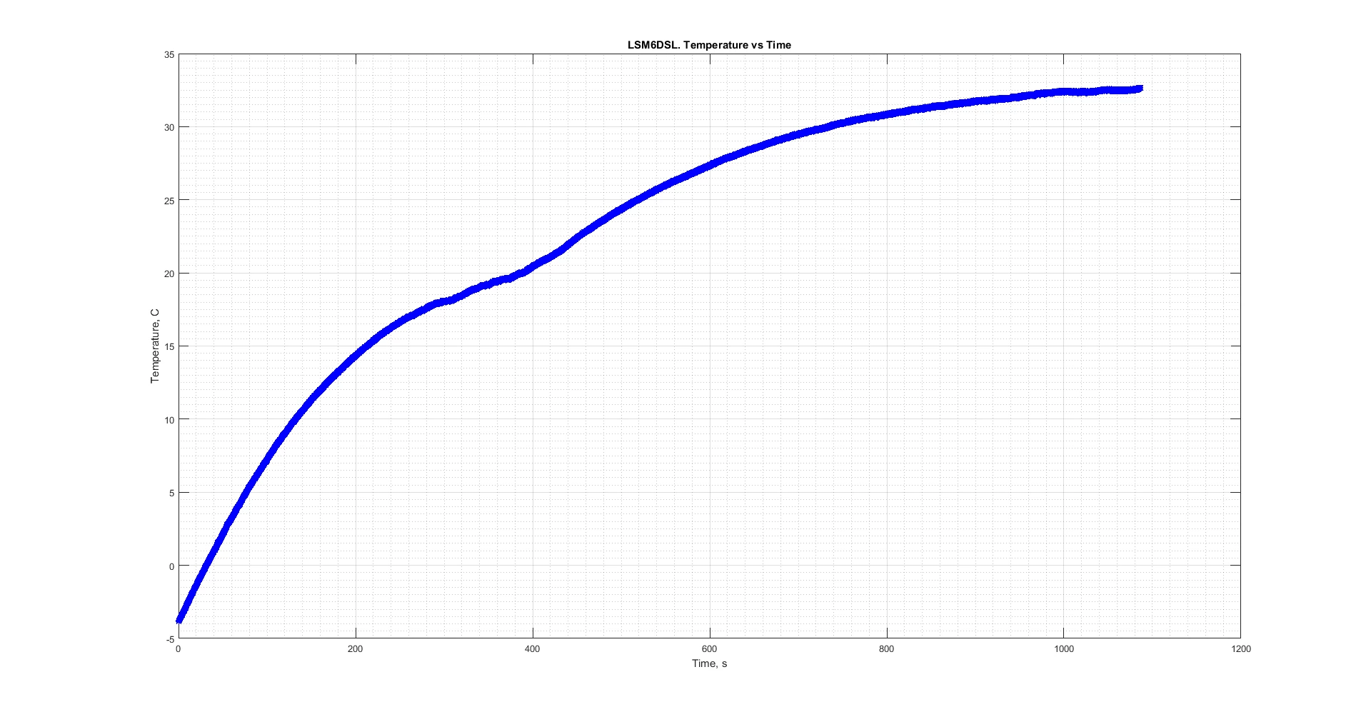

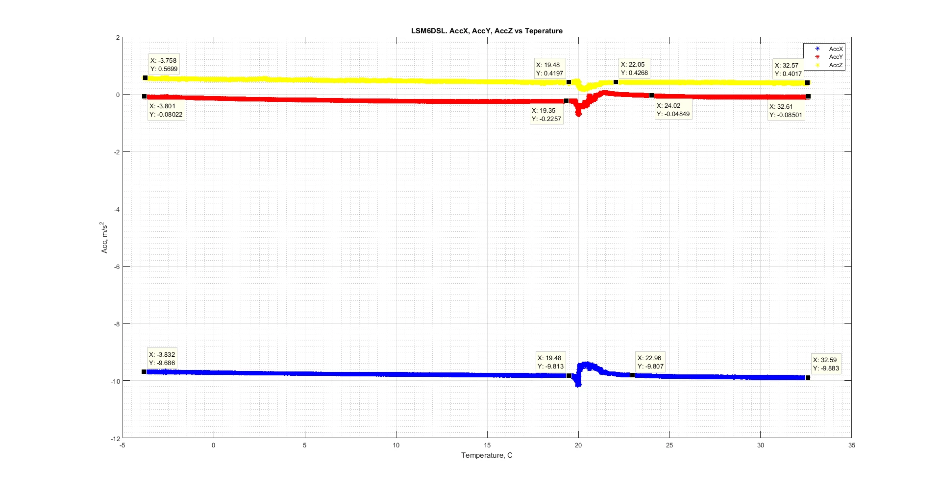

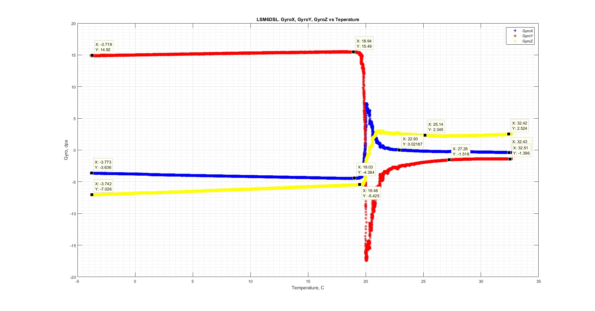

I have
conducted little research of temperature influence on accelerometr and gyroscope readings.
The sensors were cooled to a negative temperature on celsius, and then heated under the IR lamp to approximately 50 degrees in complete rest without movement.
And I have noticed some strange thing. On the graph of the dependence of acceleration and angular velocity on temperature for LSM6SL present nonlinear jump. I want to get explanation of this effect from ST developers.
PS LSM9DS1 has such effect in in a more less degree. LS303AGR hasn't such effect.

Can you please provide more details, how did you perform the test (equipment, timing, ...)? Especially how did you cool down the device?
The behavior could be caused by water accumulation during the test.

The board was cooled down in freezer compartment to approximatly -5 degrees Celsius, after that it was mounted at heavy metal substrate on by means of racks with magnetic fasteners under IR lamp with reflector. Also, the board was fenced on all sides by walls to prevent the movement of air masses.
Heating lasted about 15 minutes (see graph) At the same temperature at which the drop occurred, braking is observed in the growth of temperature
Condensation of water droplets actually occurred, but how does this affect the difference in the readings of the accelerometer and the gyroscope?
July 26, 2018
In this case it is confirmed that the problem is induced by the water (humidity). The package humidity absorption and the consequent humidity reduction due to T increase induces a mechanical stress that modify the package forces equilibrium, thus inducing stresses that affect the MEMS.
This change is transduced as a change of digital output.
