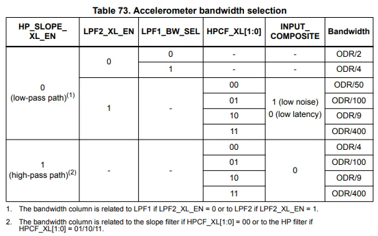

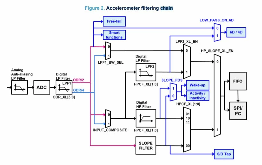

I want to measure a static object and approximate tilt angle with accelerometer only data.
With 303AGR e-compass I can easily configure the filters so a low pass filter can be set up in no time.
With LSM6DSL I am a bit lost on where or what filter I have to setup in order to achieve the same (a extremely low-pass filter, below 1Hz).

    hi David, the first LP filter (not considering the anti-alias) is configurable in CTRL1_XL (10h) reg and CTRL8_XL (17h), especially in the CTRL8_XL (17h) reg:
    to have the lowest roll-off frequency you have to select the ODR/400 case, meaning value b1011000 (58h) in reg CTRL8_XL (17h). If you set ODR below 416Hz you'll have a LP cutoff frequency < 1Hz.
    Btw, if your application is a quasi-static measure such as an inclinometer application, I suggest you the use of IIS3DHHC that is designed exactly for this purpose. Regards

    Thanks a lot, testing it!
    Is just one of the operating modes, I wish I could use a inclinometer! :)
