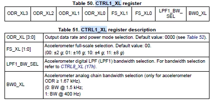

LSM6DSL: Clarification of CTRL1_XL Register description
We need a clarification in the register values of LSM6DSL for configuring g values. Is this the correct values or is it a printing mistake where 16g is given as 01 ,should'nt this value be allocated to 4g .It would be appreciated if you can kindly clarify at the earliest.

Hi @Gouri_k ,
It is correct: 01 = 16g.

Gouri_kAuthor
Oct 2, 2025 4:39 AM UTC
Thank you for the reply @Federica Bossi ,
We tested LSM6DSL sensor for shock detection with 01 configuration, but we were able to obtain only till 4g values,however when we wrote 11 to the register,we could get upto 14g values.
We need g values upto 16 g ,but we are not able to obtain that,kindly provide a solution for this issue.
Thank you.
Federica Bossi
Oct 7, 2025 9:01 AM UTC
Hi @Gouri_k ,
I tested one piece and I was able to get 16000mg. See the attached .csv file.
I set the FS at 01.
Please try to implement our official driver in Github and let me know if you solve.
