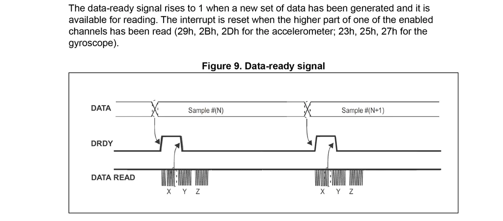

I'm seeing some very odd behavior on the LSM6DS3. It works "most" of the time, but seems to randomly change its own settings from time to time. Before we get into that, though, I'd like to ask about the timing of INT1 when driven by the DRDY signal.
In section 4.3, page 37, the appnote says:
That's pretty explicit: DRDY should be deasserted when register 0x29 is read. At the bottom of this figure you can see that it illustrates the trailing edge of DRDY at the *end* of the X axis data transfer, which makes sense because X's data is in registers 0x28 and 0x29.

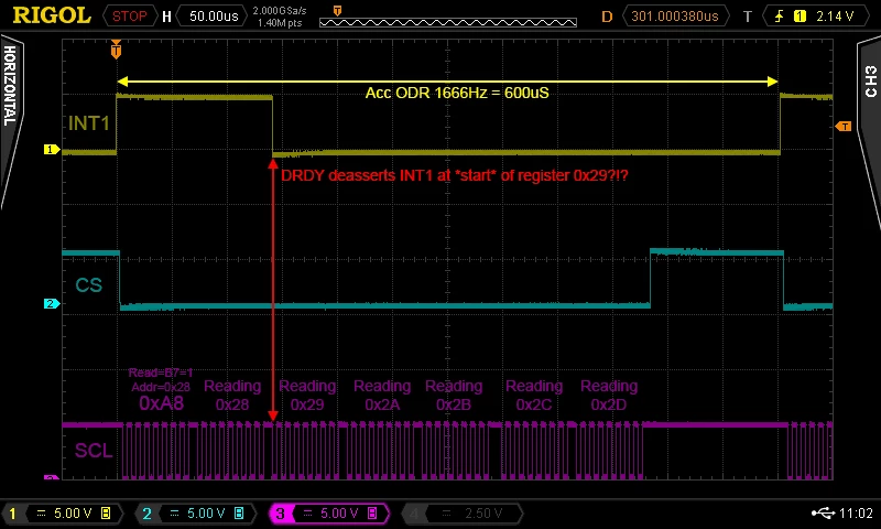

Now look at what the LSM6DS3 actually does on a scope:
The bottom trace is SCL (not MOSI), so you can see the individual clock pulses. The red arrow shows how INT1, which is being driven by DRDY (INT1_CTRL/0x0D = 0x01), deasserts not at the end of the X axis data, but between the two bytes of X axis data. This directly contradicts the appnote figure above. Is this behavior controlled by a flag somewhere?

Eleon BORLINI
May 8, 2019
Hi, did you set the DRDY function in the right way? Which is your INT1_CTRL configuration? E.g. keep care of the (DRDY mask functionality). Regards
IDEngineer
May 8, 2019
Yes, DRDY was always set properly. The question was one of timing... what the appnote says is NOT what actually happens, as my original post above illustrates. However, extensive testing has shown that INT1 does work - just not as the appnote describes - and we have been able to make progress.

Eleon BORLINI
May 9, 2019
​But at which Vdd / VddIO are you working? From the oscilloscope it seems you are at 5V... Regards
IDEngineer
May 9, 2019
The LSM6DS3 is running on 2V5 for both Vdd and VddIO. The signals on the scope are measured at the microcontroller, which is a 5V0 part. The signals are properly translated in both directions between the two components.
Eleon BORLINI
May 10, 2019
​Please be sure of the integrity of the signal that passes through the voltage translators, especially if they are bidirectional. Regards
IDEngineer
May 10, 2019
They are not bidirectional. This is a four-wire SPI interface, so none of the four signals are bidirectional. The signals at the LSM6DS3's pins are just as clean as those in the scope screenshot above. I can take a screenshot of the 2V5-level signals at the chip's pins if you like, but I promise they're nice and clean.
