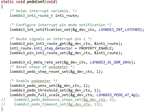

I'm trying to read step counts. I'm executing all pedometer related functions, but I get no any output.

    Hi @Eleon BORLINI​ ,
    I applied the configurations in the application note as mentioned. But the result is the same, negative.
    static void pedoConf(void)
     /* Holds reset variable. */
     uint8_t rst = 0;
     lsm6ds3_reset_set(&g_dev_ctx, PROPERTY_ENABLE);
     do
     lsm6ds3_reset_get(&g_dev_ctx, &rst);
     }while(rst);
     /* Enable Block Data Update */
     lsm6ds3_block_data_update_set(&g_dev_ctx, PROPERTY_ENABLE);
     lsm6ds3_int1_route_t int1_route_t;
     /* Set Output Data Rate for Acc and Gyro */
     lsm6ds3_xl_data_rate_set(&g_dev_ctx, LSM6DS3_XL_ODR_26Hz);
     lsm6ds3_gy_data_rate_set(&g_dev_ctx, LSM6DS3_GY_ODR_26Hz);
     lsm6ds3_xl_full_scale_set(&g_dev_ctx, LSM6DS3_2g);
     lsm6ds3_gy_full_scale_set(&g_dev_ctx, LSM6DS3_2000dps);
     /* Enable pedometer */
     lsm6ds3_****_sens_set(&g_dev_ctx, 1);
     lsm6ds3_pin_int1_route_get(&g_dev_ctx, &int1_route_t);
     int1_route_t.int1_step_detector = PROPERTY_ENABLE;
     lsm6ds3_pin_int1_route_set(&g_dev_ctx, &int1_route_t);
     lsm6ds3_int_notification_set(&g_dev_ctx,LSM6DS3_INT_LATCHED);
     /* Reset steps of pedometer */
     lsm6ds3_****_step_reset_set(&g_dev_ctx, PROPERTY_ENABLE);

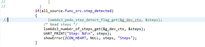

     if(all_source.func_src.step_detected)
     /* Read steps */
     lsm6ds3_number_of_steps_get(&g_dev_ctx, &steps);
     UART_PRINT("Step: ");
     UART_PRINT("%d\n", steps);
     showError(ICON_HEART, NULL, steps, "Steps");
    In while loop, the way that I check if there is a detection or not. What can it possible error and how can I solve it?

    Eleon BORLINI
    Mar 16, 2021 2:44 PM UTC
    Hi @TKCK.1​ ,
    I'm not sure if I well interpreted your code, but I suggest you to try to implement the in the way it is described in the LSM6DS3 application note AN4650, p.62:
    1 Write 20h into CTRL1_XL // Turn on the accelerometer
    // ODR_XL = 26 Hz, FS_XL = ±2 g
    2 Write 3Ch into CTRL10_C // Enable embedded functions
    3 Write 40h into TAP_CFG // Enable pedometer algorithm
    4 Write 80h into INT1_CTRL // Step Detector interrupt driven to INT1 pin
    This deploys the embedded pedometer feature, without the need of additional configuration of parameters such as debouncing and threshold.
    -Eleon
