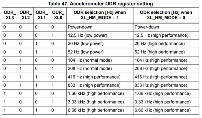

LSM6DS3 linux driver for ODR of 1666 Hz
Hello STM,
looking the the mainline kernel for the IMU line, i see some comments in the code that say the only supported ODRs are that of up to 416 Hz. is it possible to run the sensor in high performance mode with the current linux driver? Is there a patchset that provides support for this or is this something that is unsupported with linux?

Hi wes @Weden.1​ ,
it should be possible -at least theoretically-, but I'm not an expert of these drivers.
Please refer to the Linux drivers on Github, for the specific product LSM6DS3 (st_lsm6ds3).
Here the limit is 416Hz too:
#define ST_LSM6DS3_ODR_416HZ_VAL		0x06
Probably it is enough to add a define with the values according to the codification you can find on the datasheet p.54.
But for these kind of requests I suggest you to open an issue directly on Github (LINK:( ST experts will help you, usually within a week.
Please keep me updated about your request.
