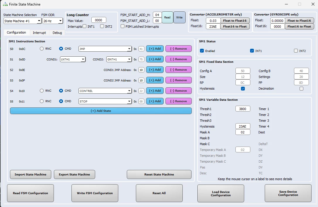

Hi all,
I'm trying to move Finite State Machine config from devkit using Unico GUI to final application. I've prepared movement wakeup example from FSM datasheet in Unico, which is working totally fine on devkit, it could even detect knocking in desk.

And it seems that it was programmed correctly, however it doesn't bring me any interrupts. When I try to break it, for example commenting last 2 bytes, I get the same infinite interrupts behavior as I mentioned in the beginning.
What other cause could there be for the fsm not working properly?

Hi @mpopko ,
We are doing some analysis to better understand which could be the problem. In the meantime can you confirm me that you haven't generated an .ucf file?

Hi @Federica Bossi
I'm attaching both .fsm and .ucf files which are working fine on devkit.
