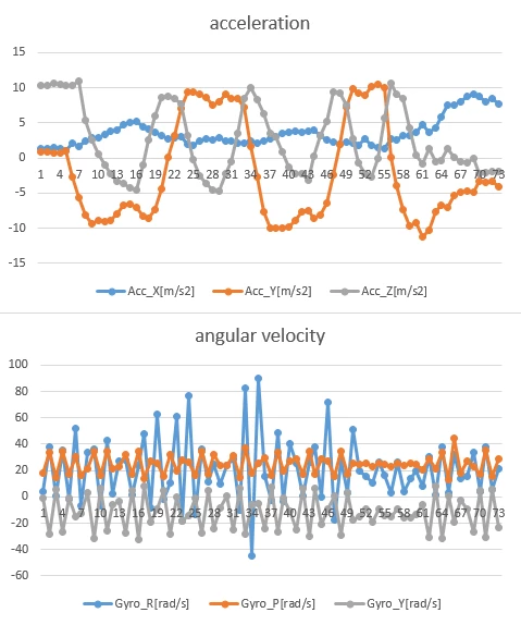

Hi, I'm in trouble about LSM330TR gyroscope power_down mode.
I'm measuring the angular velocity every 100ms and when it isn't measuring, i'd like to implement power_down mode.
I wrote such a program but t
he gyro data is just a random variant number.
When I use only normal mode, it works correctly.
How long does it take to start up from power_down mode to normal mode in gyroscope sampling sequence?
Please help me.

The turn-on time from power down to normal mode is 150ms so you can you this approach if you want to measure the value each 100ms.

Thank you Miroslav, I made sure it works correctly!
