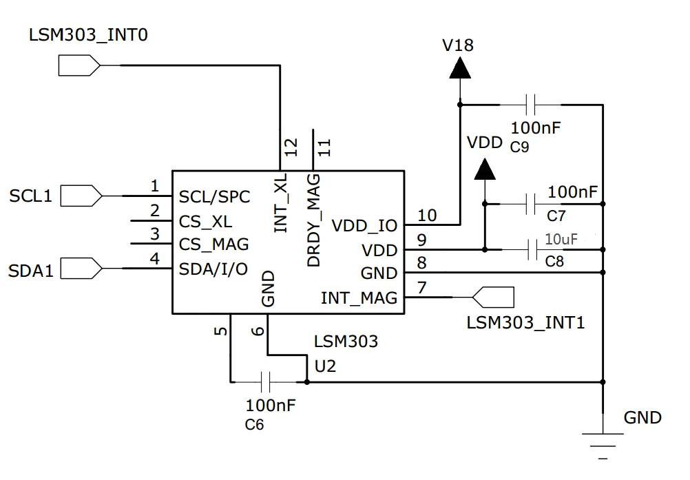

Can you share your schematic?
yanqin gem
May 23, 2018
Posted on May 23, 2018 at 03:57
hi,  Microslav B
    this is our schematic.
May 23, 2018
Posted on May 23, 2018 at 16:32
The CS_XL and CS_MAG cannot be let floating, for I2C communication they must be connected to VDD_IO.
