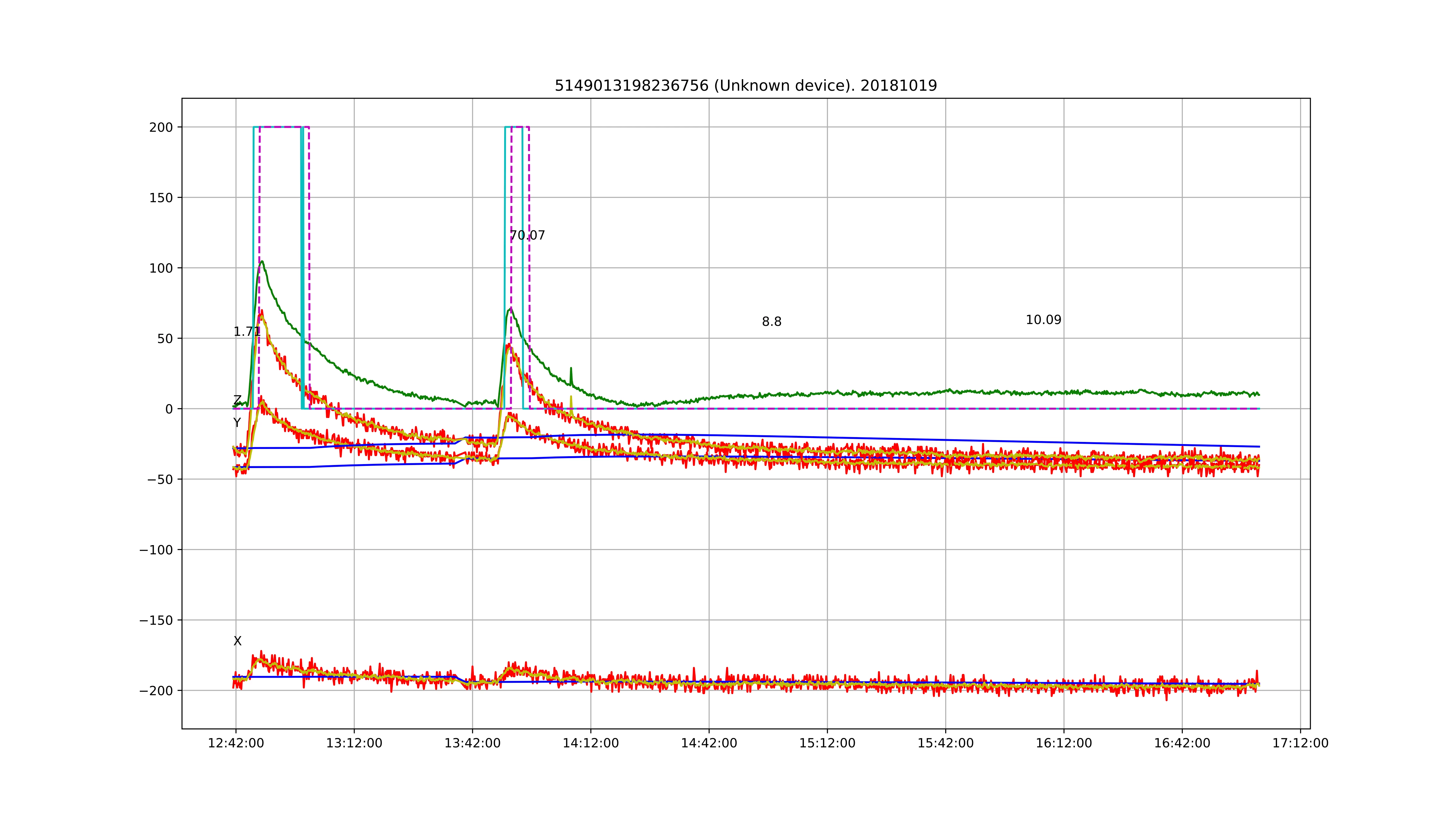

Temperature compensation for this magnetometer is not working as I expect. When heating device from room temperature to 50-60 degrees Celsius in 3 minutes magnetometer values are changing a lot.
I have 100Hz ODR, high-precision mode, temperature sensor and temperature compensation enabled, offset cancelation disabled.
Anyone having an idea what else should I set up? What is the normal (delta C / minute) which sensor can work with while compensating properly?

You have to also enable offset cancellation, to achieve specified offset vs temperature.

What it means the values are changing a lot?
Can you please share your results and exact sensor configuration so I can check it?

Oct 22, 2018 12:41 PM UTC
@Miroslav BATEK​
Here is the log from the device, raw value is plotted in red. So change is around 100, 50 and 15 mGauss for Z, Y and X axes respectively.
I would be happy if all 3 axes will behave as X but in current setup it gives me false positives.
My initialization code is:

I am sure that I have COMP_TEMP_EN = 1 and TEMP_EN[1:0] = 1

@Miroslav BATEK​ did you have any chance to look at it? Is it normal behavior of the sensor or not?
Miroslav BATEKBest answer
Oct 25, 2018 8:41 AM UTC
