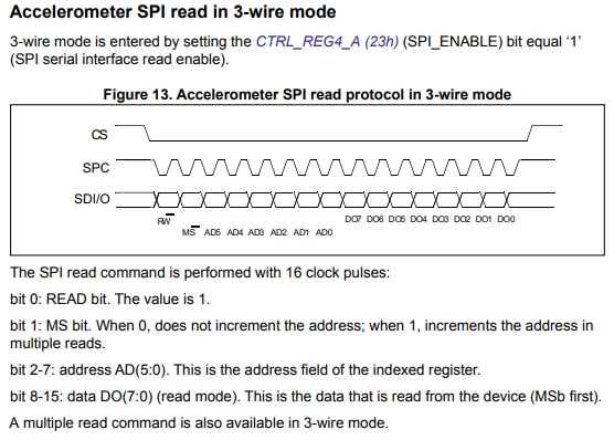

Hi
I have lsm303agr mems sensor with stm32g4. It uses 3 wire SPI mode. I have problem with SPI communication. I used CubeMX with HAL mode and STMems_Standard_C_drivers for lsm303. The problem is that, when i read whoami register it reads 0x33 which is correct. But the next time i read as 0. Next time again 0x33 and so on. It reads 0x33 and 0 sequentially. SPI times out. I have seen HAL examples written only for Full duplex communication. So, i used CubeMX with SPI in half duplex mode to generate the project. This is my code snippet:
while(1)
HAL_GPIO_WritePin(GPIO_Sensor, CS_Sensor_Pin, GPIO_PIN_RESET);
HAL_Delay(1);
HAL_SPI_Transmit(&hspi1, &whoami_addr, 1, 1000);
HAL_SPI_Receive(&hspi1, &whoami_val, 1, 1000);
HAL_Delay(1);
HAL_GPIO_WritePin(GPIOA_Sensor CS_Sensor_Pin, GPIO_PIN_SET);
Am i missing something with SPI 3-Wire mode?
Best regards.

    Hi @AAYKA.1​ , can you check how you configured the SPI at master side (8bit or 16bit)? Did you perform multiple readings continuously? And after which event does the SPI go in timeout? Here below is the 3-wire SPI data pattern (p. 41 of the datasheet), please check if you followed all the indications. Appreciated if you can share the pattern analyzer data.
    Regards
