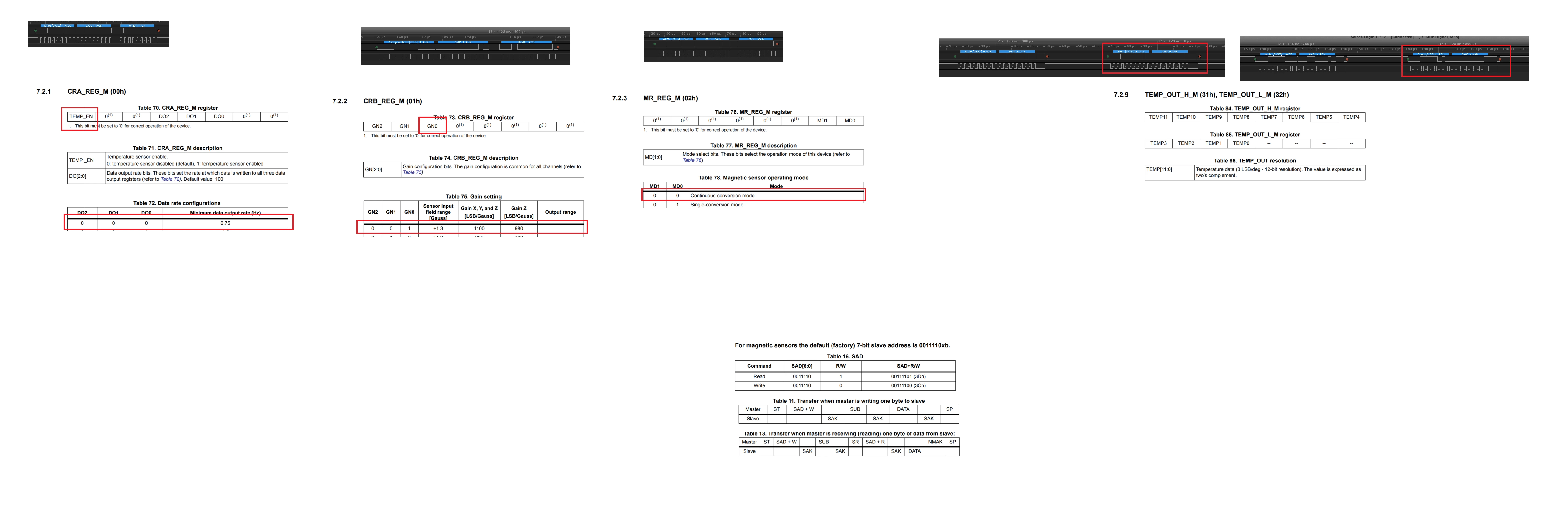

It's returning ack on the i2c on every command , and i'm getting an error if it's not the correct address.
I'm attaching image from the scope of the i2c commands and responses.
The configuration done first and then I'm reading the temperature that it always zeros.
Also when I'm reading the config registers I'm also getting zeros.
Please advice. Thanks.
    Best answer by netanelu
    Thanks you all, It been fixed.
    Need to take close look at that:
    "Registers 00h through 3Fh are dedicated to the accelerometer while registers 40h through 6Fh are dedicated to the magnetometer. "

    ​Hi @netanelu​ , what if you read the WHO_AM_I_A (0Fh) register? Regards
