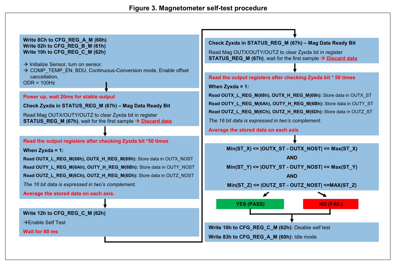

I'm using the LSM303AGR magnetometer with an STM32L4 via I2C + HAL. The built-in self-test works fine for X and Y, but Z-axis always fails — the delta (self-test vs. normal) is out of range.
   Set Up
  • STM32L4, I2C, HAL drivers
  • Magnetometer config: 50 Hz, continuous mode
  • Self-test enabled via CFG_REG_C_M (0x62) = 0x12
  • 50 samples averaged before/after self-test
  • Delays: 200ms (pre), 500ms (post self-test)
     Problem
  • X/Y deltas: within 100–1000 LSB range → pass
  • Z delta: often too low or too high → fail
  1. Are 100–1000 LSB valid self-test limits for Z?
  2. Is 500ms delay enough after enabling self-test?
  3. Do I need to read output registers in burst mode for sync?
  4. Any known Z-axis issues in continuous mode?
Any advice or working examples appreciated!

The self test procedure is outlined in AN4825. Follow that exactly and show the numerical results you get along with relevant code.

I shared complete example of the LSM303AGR magnetometer self-test, based on AN4825. This was tested on an STM32 platform using HAL over I2C. Below is the implementation and test results.

Output:
Self-test ENABLED: CTRL_REG3_M = 0x12
Self-Test Results:
X: nost = -106, st = 35, Δ = 141 [PASS]
Y: nost = -186, st = -61, Δ = 122 [PASS]
Z: nost = 356, st = 412, Δ = 58 [FAIL]
LSM303AGR Magnetometer Self-Test FAILED
