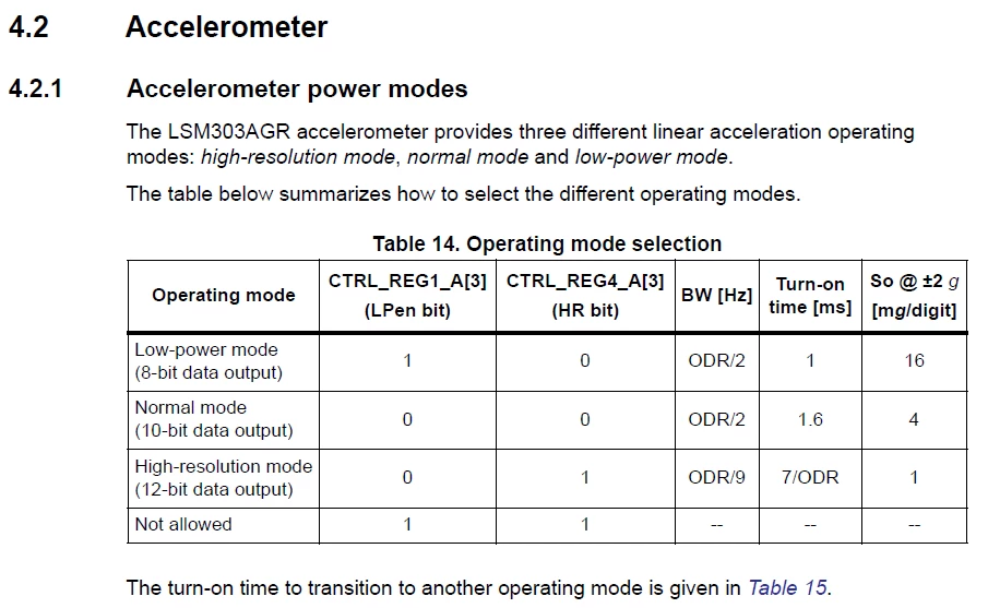

Can anyone explain to me how to calculate the correct acceleration values in mg for various resolutions and scales?
For example, I am currently reading acceleration values with  ODR set to 0110, which is  HR / Normal / Low-power mode (200 Hz). The Full scale selection is set to +/-2g for this example.
As both the LPen and the HR bit are set to 0, I am in Normal mode with a 10-bit data output. If I shift the values >> 4, I am getting values which seem to be correct. For example 1000 mg (= 1g) on the z-axis, which makes sense I guess, as it is 1*gravitational acceleration.
On the right of the table above is written: +/- 2 g [mg/digit]. What does that mean? How am I able to convert the values I read into mg? Not only for +/- 2g, but for a fullscale of +/-4g or +/-8g or +/-16g too?

16 infers you're immediately throwing away 4-bits of precision, and 4 for 2-bits
You must take your signed integer value and scale it into the range you've selected.
For 12-bit I'd assume +/-2048 translates to +/-2g in that mode, unless some specific scaling value is called out
int X;
double x;
x = (double)X * (2.0 / 2048.0); // Value in G
x = (double)X * (2000.0 / 2048.0); // Value in mG
x = (double)X * (2.0 / 32768.0); // Value in G if value in X is left-aligned within a 16-bit integer

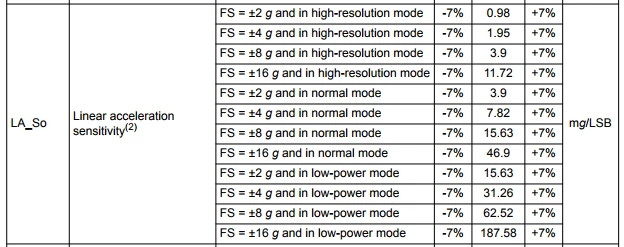

The value which describes relation between raw data and acceleration in g is sensitivity. You can find the values in Table 3  if datasheet for all full scales and modes.
The output value is left justified in the output 16 bit register, so you have to first shift the value right according to selected mode (8, 10, 12 bit).
You can do it for example like that:
int16_t result_lsb;
float result_mg
result_lsb = ((int16_t)high_byte<<8)+(uint16_t)low_byte;
result_lsb = result >> 4; // in case of high resolution mode = 12bit output
result_mg = result_lsb * sensitivity; // LSB to mg, see sensitivity in datasheet
