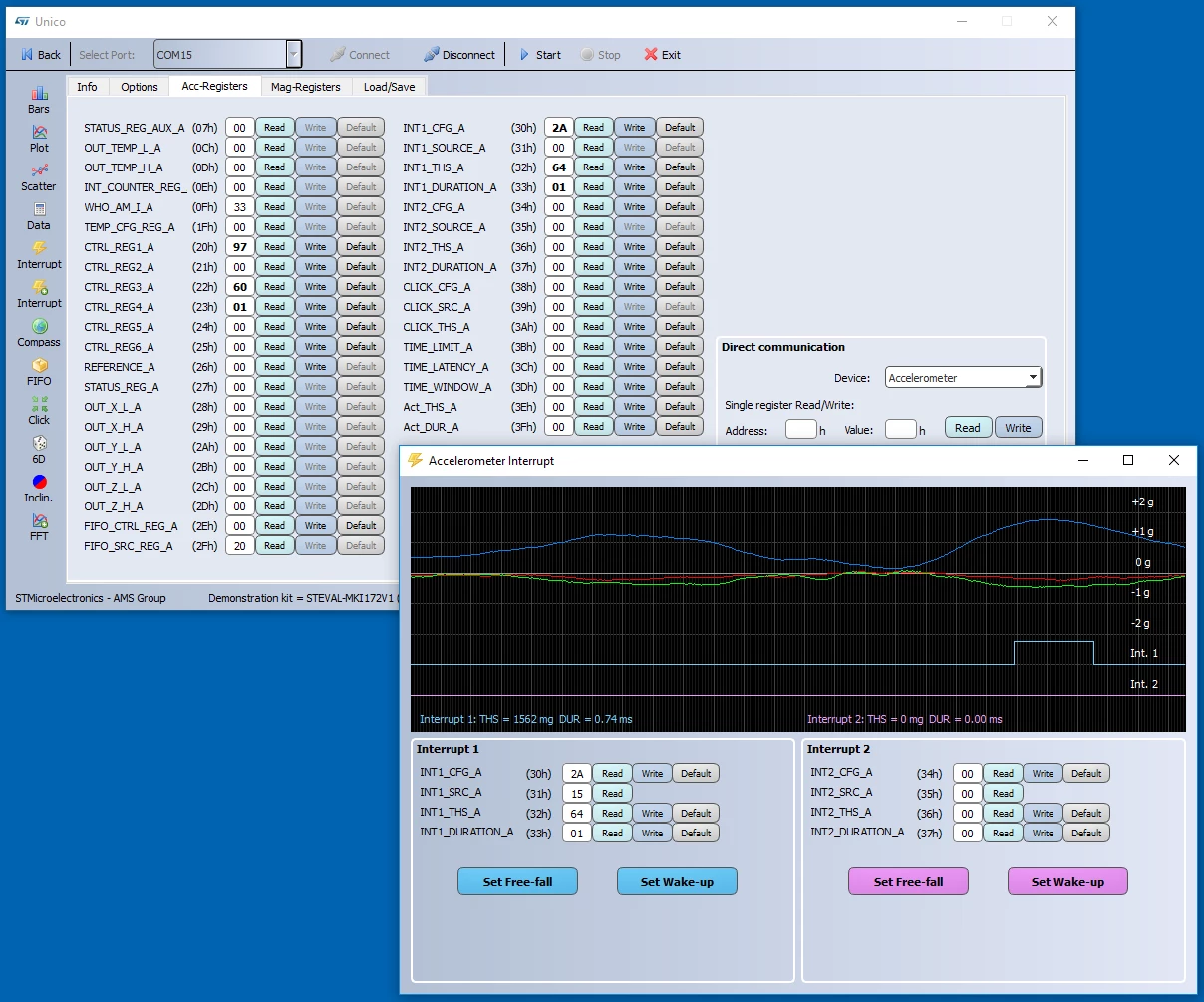

LSM303AGR INT1 / INT2 unable to make it work
Posted on June 26, 2018 at 18:17
After properly setting up i2c with my choice MCU, INT1 is never fired. (I have tested with logic analyzer and INT1 pin is always low, and its configured as active high)

Even if I don't know why you mix the high level function with direct register access, you configuration seems OK to me.
I'm able to get the interrupt from the device with you configuration, if I share with the board.
Is your INT pin connected to a MCU? If so is the GPIO configured as input? Are you sure that MCU or other device don't force the line low?

It is possible to use the Unico GUI with x-NUCLEO-IKS01A2??  that options seem very handy to debug the register configuration.
Thank you is working now, for some reason the high pass filter was disabled and the interrupt was triggered forever so the MCU was not counting interrupts.
