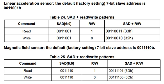

I've gone through the documentation a few times and I'm not sure what I'm missing. I'm using an STM32L4 to control the lsm303agr through an i2c connection. When I run debug and probe the SCL/SDA lines on my oscilliscope, the messages look good, and from what I am seeing I am getting a slave acknowledge at the end of each transmit.
I first noticed when I was collecting data to calculate hard iron compensation values that after I thought I had sent calibration data to the registers that my collected data looked exactly the same. I made a function to read out the OFFSET registers, and the lsm303agr sends back that all 6 offset registers are 0x00 (seen both in debug and oscilliscope)
Am I getting the procedure to load the compensation data to the registers incorrect?

	msg[0] = CFG_REG_A_M;
	msg[1] = 0x88;
	HAL_I2C_Master_Transmit(&hi2c1, ACC_ADDR, msg, 2, HAL_MAX_DELAY);
	//CFG_REG_B_M
	msg[0] = CFG_REG_B_M;
	msg[1] = 0x02;
	//CFG_REG_C_M
	msg[0] = CFG_REG_C_M;
	msg[1] = 0x10;

	msg[0] = OFFSET_X_REG_L_M;
	msg[1] = 0x7F;
	msg[0] = OFFSET_X_REG_H_M;
	msg[1] = 0xFF;

Hi @HIngv.1​ ,
When you set the magnetometer configuration and hard-iron compensation you use ACC_ADDR instead of MAG_ADDR. Please, try to use MAG_ADDR as described in Table 25 below and let me know if you fix the problem.
