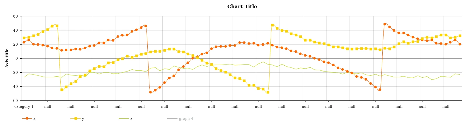

I collected raw data from magnetometer 2 times ( first time with my own library and then with XNucleoIKS01A2 library from this example
https://os.mbed.com/teams/ST/code/HelloWorld_IKS01A2/
 ). Datas are very similar in both cases (expressed in gauss). Compass was rotated around Z axis, step by step, by several degrees. Compass was at horizontal position with 0 titl angle.0690X0000060LXcQAM.png
It looks like sine and cosine functions, but with movements. I tried to remove these movements and after I had following data.

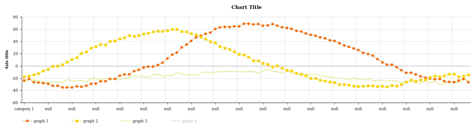

And then I tried to transform it in

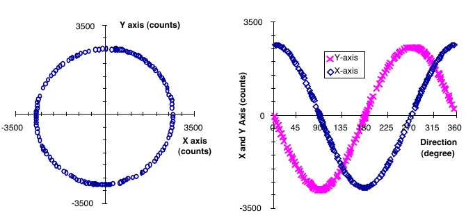

because I want to reached result, which is similar to this:
These pictures origin from this document:
https://aerospace.honeywell.com/en/~/media/aerospace/files/technical-articles/applicationsofmagnetoresistivesensorsinnavigationsystems_ta.pdf
I need ellipse to compensate ''hard iron'' (offsets for register) and ''soft iron''(factors for converting ellipse to circle). These steps provide clear calibrate data for MotionEC library and this library will counts necessary data for me.
